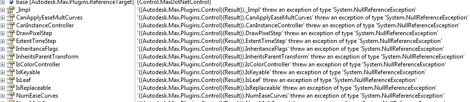

It happens with all versions of the Max.Net SDK + different Visual Studio Versions + different 3D Max Versions + Different Net.Frameworks :-(
And the created MaxDotNetControl (Control Sample) has many NullReferences (Screenshots)
Anybody has an idea?
