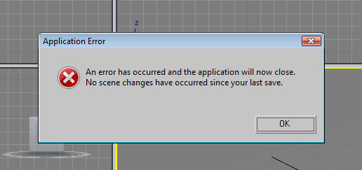

From the Autodesk Error report:
"Application: 3ds Max    Version: 3ds Max 11 - 64 bits       Error: Unhandled Exception"
Attached image of error dialog from Max before it closes itself.
I get exactly the same result in Max 2009 32-bit and 64-bit versions. Basic geometry and utility plugins appear to work correctly.
