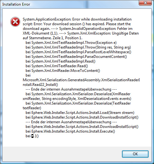

Hi Marsel,
thank you for providing the new version of Max.Net.
Unfortunately, we have troubles installing the new version. Using the offline installer we receive an installation error dialog as shown in the picture attached to this thread.

Hi Christian,
Did you by any chance rename the installer? Install session is part of the installer name so if you rename it, it will no longer work properly.

I didn't changed the name of the offline-installer, I tried it one more time, and the error message showed up again. The online-installer worked.

I will also check the offline installer, something must have broken down.
The offline installer should be behaving much nicer now. Also uninstalling should work properly.
