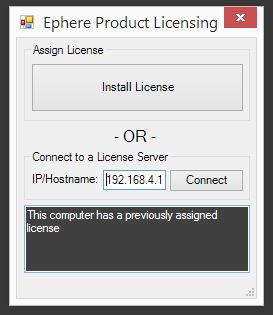

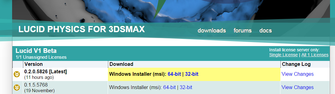

| I also have a question related to the license. I would like to install the license server so I could open lucid on one of two different machines - each have different video cards and other hardware. I clicked the "All 1 licenses" link (in attached picture) and The Ephere Product licensing app was downloaded (233kb). Is the following correct? 1) Open the License app on the license server machine 2) press "License This Computer" 3) Close the LIcense App 4) Go to another PC and open the License App 5) Enter the IP of the original license server machine and hit "connect" Just wanted to check incase that's not correct. Attached Files: Michael Wentworth-Bell -- Test system for Lucid: i7-4790k GTX 780 6GB 32GB Ram Windows 7 Pro 3ds Max 2016 EXT2 -- Portfolio - http://thelode.com.au Facebook - https://www.facebook.com/DigitalLode |
| Hi Michael, Correct up two step 3. After pressing "License This Computer" if all goes well the app should close itself. Then on another computer you just need to run Lucid and when presented with an "enter up" dialog inside Max enter the IP of the machine where you installed the license server. Marsel Khadiyev (Software Developer, EPHERE Inc.) |
