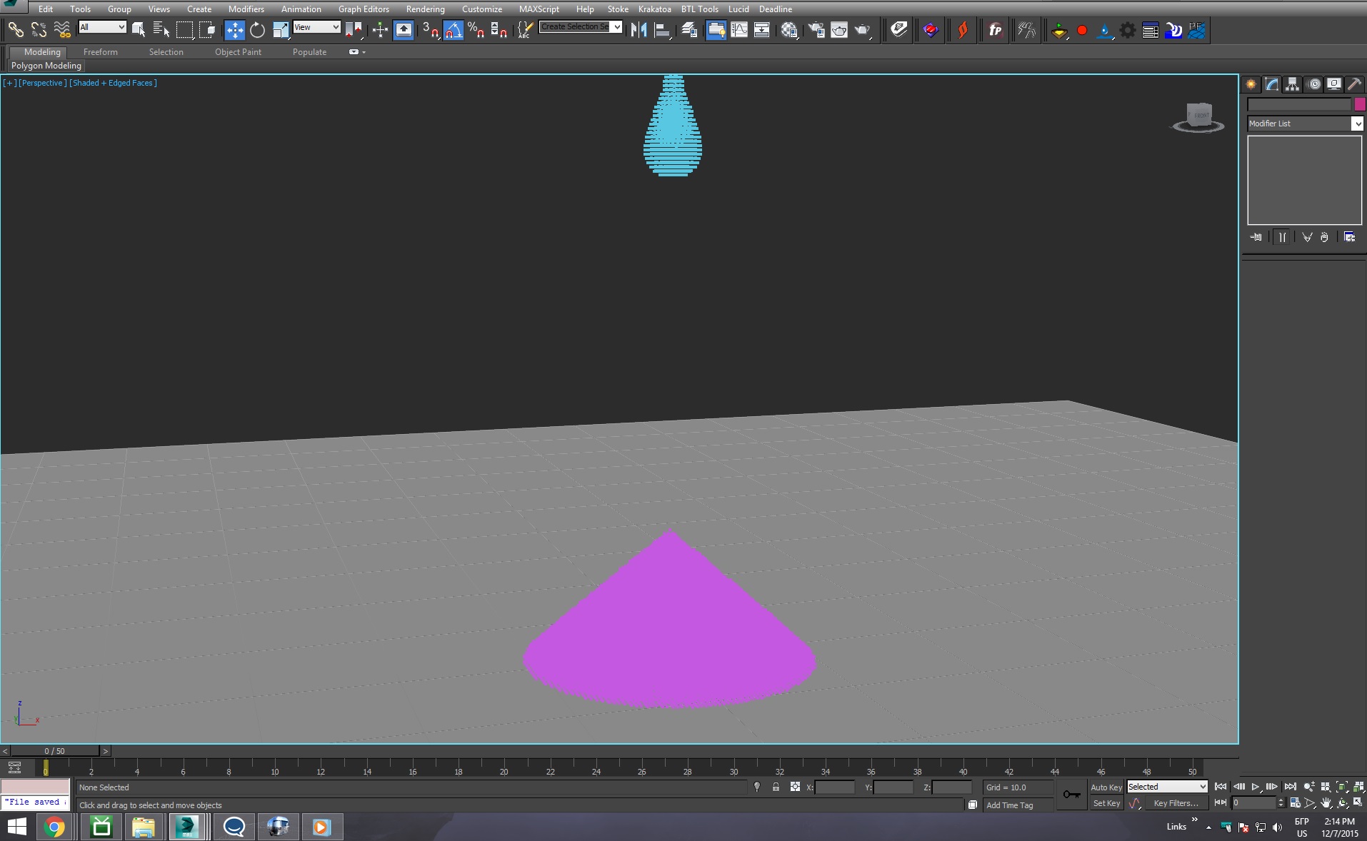

Is it possble to assign different viscosity on two objects at same time or it is controlled by global settings only? I want the pink object to remain still (as its first frame ) untill get hit by blue droplet Attached Files: |
| Viscosity is assigned globally at the moment, it is a limitation of Flex. We will have to see if this changes in the future. Marsel Khadiyev (Software Developer, EPHERE Inc.) |
