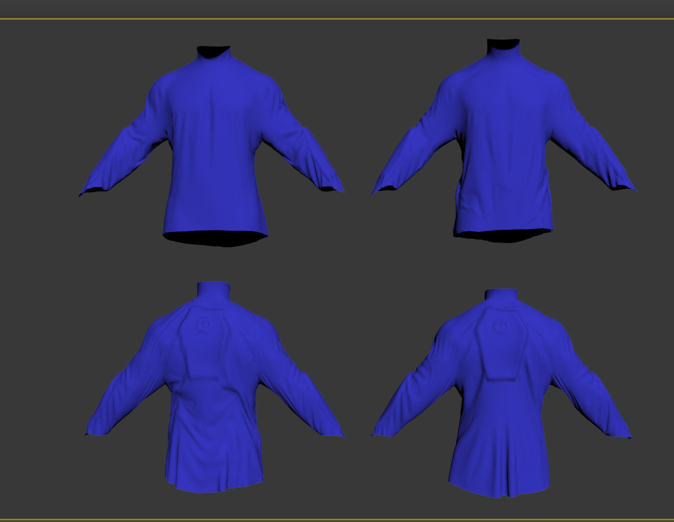

Hi marsel,   Thanks for your reactivity.
I'm on a commercial/confidential project and i must do 3D cloth for a brandmark.
I play a lot with all settings but it's like searching the door in a black room.
The cloth simulation works but i can't achieve what i need.
All my cloth looks like silk pyjamas.
The best i get is in this picture, but still don't look like hard cloth.
Kwen

Hello Marsel ,
I tried huge value as 300 sub-steps and it's getting better ...
Still trying ...
