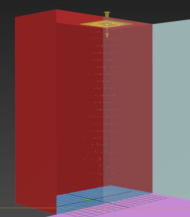

Hi there, I am not that well know with particles and Lucid yet. But I am eager to learn! So I need some help with the following issue. My client would like to see for a still, water comming out of a rain shower and splashing on the floor. How can I achive this? Cheers Johan
| After diving into the you tube channel, I came up with something. Not sure if I am on the right track I have some sort of setup which feels right. Once I try recording Max (2016) is crashing. edit: added file and screenshot |
| Looks like a good start in the scene. Alternatively you can also try using the Lucid PF geometry operator if you want water to come out in bigger clumps. I opened your scene and recorded it without any problems. Are you still having the crash in the latest version of Lucid? Marsel Khadiyev (Software Developer, EPHERE Inc.) |
| Hi Marsel I still have problems, even with opening the scene. Even if I try to open your "Rain" scene, Max is crashing. I have version 1.0.6.6685 installed and have a K4000 as graphic card. By digging further into the tutorials I figuerd out about Lucid PF geometry. Due to the deadline, I managed to get a descent result with PF. But will contonue polyshing my Lucid skills. regards Johan |
| Hi Johan, I can open the scene without any problems. Did you make further modifications in it? If yes can you please send it to me, the one that crashes? I would like to investigate it further. Marsel Khadiyev (Software Developer, EPHERE Inc.) |
| Here you are, both files causes Max to crash cheers Johan |
| Very strange, both these files open and simulate OK here. At which point does the crash happen? Marsel Khadiyev (Software Developer, EPHERE Inc.) |
| With both files, during "loading..." |
| Yup, can now confirm the crash in a release build. Investigating... Marsel Khadiyev (Software Developer, EPHERE Inc.) |
| Please try it with the last nightly build, I cannot reproduce the problem there: https://ephere.com/plugins/autodesk/max/lucid/1.1.0.6.6823_win64_343520302031.msi Marsel Khadiyev (Software Developer, EPHERE Inc.) |
| Hi %arsel I can confirm that both files do not crash anymore. And they both record fine! Tanks Johan |
