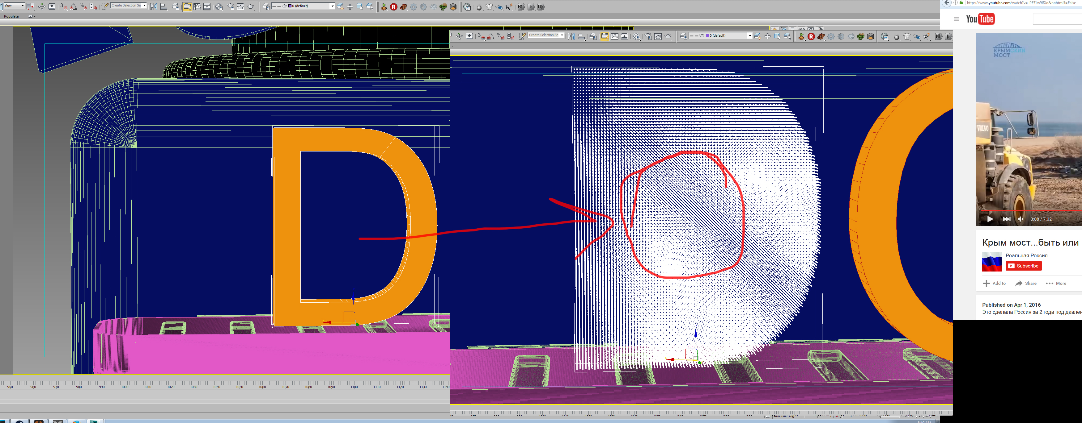

Hi i am trying to convert letter D  to liquid but innder part of letter D also has particles. Why is that?
Thank you
here is image

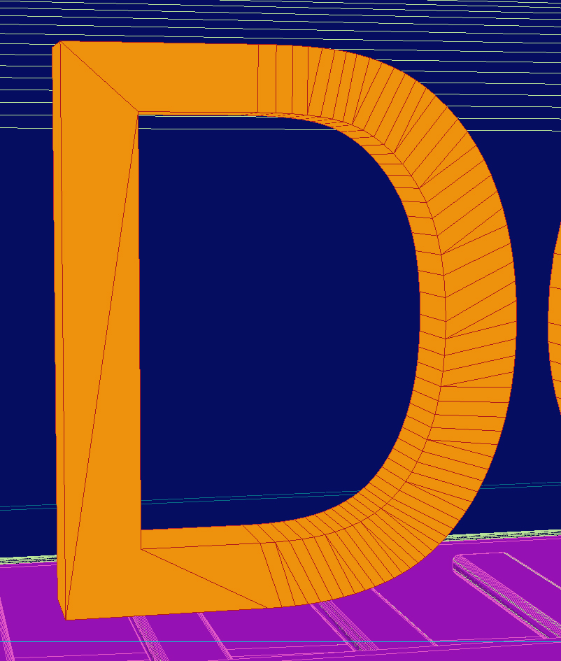

Are you using 3dsmax's text tool? Looks like it could be the topology configuration of the letter which is confusing the voxelizer.
Thank you it works now   instead of Cap I have to actually have polygons on the front connecting each dot
