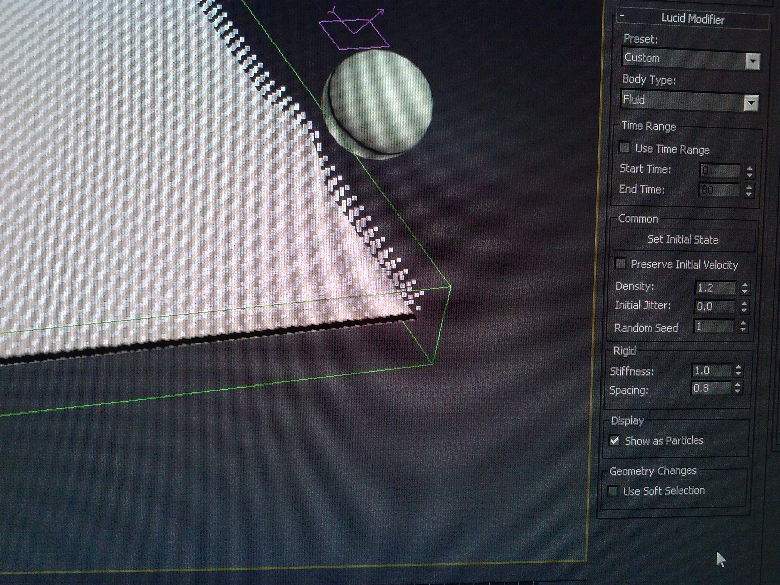

 So here is a photo taken of my screen. You can see the display particles are square flat boxes... Not sure how to make them display as cubes like in your demo videos...

Did you mean to attach the image? Or maybe you can send it to me directly by email?
yes i meant to attach sorry!
