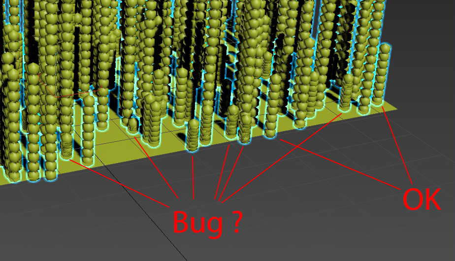

- It work on some guides, but some other are really stack. see attached image.

The animations are looking very decent!
  • The very short strands have a minimum number of particles which is needed for simulation to be stable. I can try to make this number smaller or maybe add an option to make very short strands not part of simulation?
