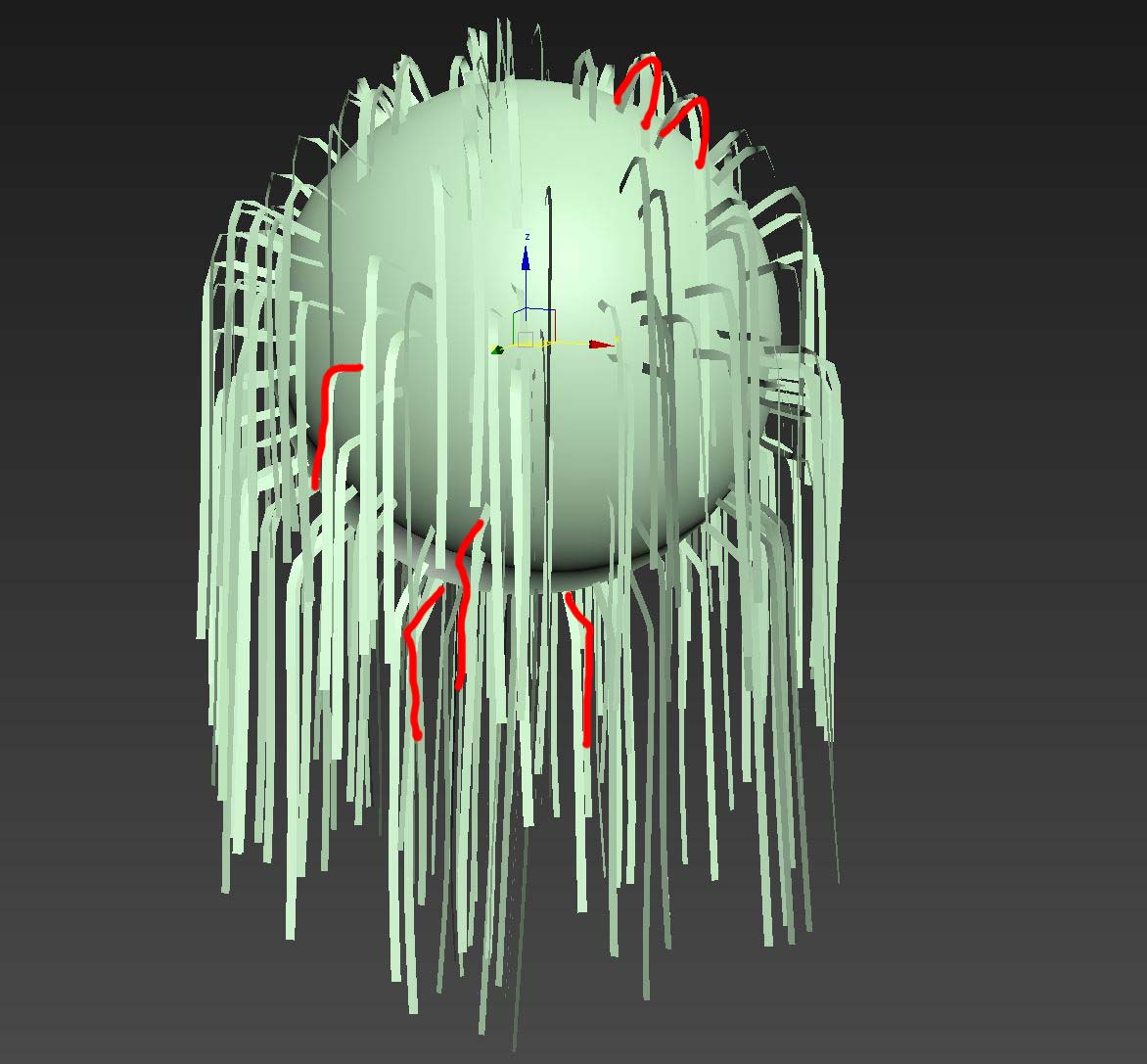

Well the next thing and most important is that after many many tests on a single sphere, i cant find some settings that make the hair stop instead of bouncing forever. The more i add substeps or iterrations, the more they bounce. Can u provide me a scene with hair on a sphere, just dropping and behaving proper without needing 1000 frames to stop moving (and not all of em some still move like crazy). Cause i like the "default" but i ll probably need tweak a bit, and adding flex object just completely ruins the first setup.

| Have you tried increasing the drag/damping values in Flex Settings object? Marsel Khadiyev (Software Developer, EPHERE Inc.) |
| Ya i think i added some ridiculous number in drag, like 100 cause i coudlnt see any difference at all. Do these parameters work with hair? I ll try again with a fresh eye and get back to u! What damping does practically and what values work for both drag and damp usually? thanks |
| Finally! Damping seems to get the job done! Rest parameters do not do nothing at first glance. Still there is this issue with roots bending no reason. Even the roots at the bottom of the sphere are bending. See image below. There must be a setting somewhere preveting this from falling proper, cause its the same distance again around 5.5 cm |
| Have you tried displaying as particles to see what the lattice looks like? Also have you tried increasing/decreasing hair segment count? Marsel Khadiyev (Software Developer, EPHERE Inc.) |

| Hi Thanos, Please see attached scene, I think it gives better results in terms of simulation with less damping. The issue with roots sticking out is fundamental, Ox Dynamics does the same thing. The first segment in the hair needs to point outwards, otherwise the hair would always collide with the distribution mesh. The scale and number of segments should reduce this distance though. Marsel Khadiyev (Software Developer, EPHERE Inc.) |
