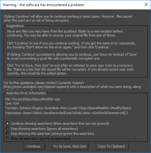

> 6. I get exceptions every time I start a simulation file. I have to say "don't bug me" and just continue. I've never not-had that warning pop up to my recollection.
Can you please list the exact steps to reproduce this from scratch? Looks like a bug which needs to be fixed on high priority.

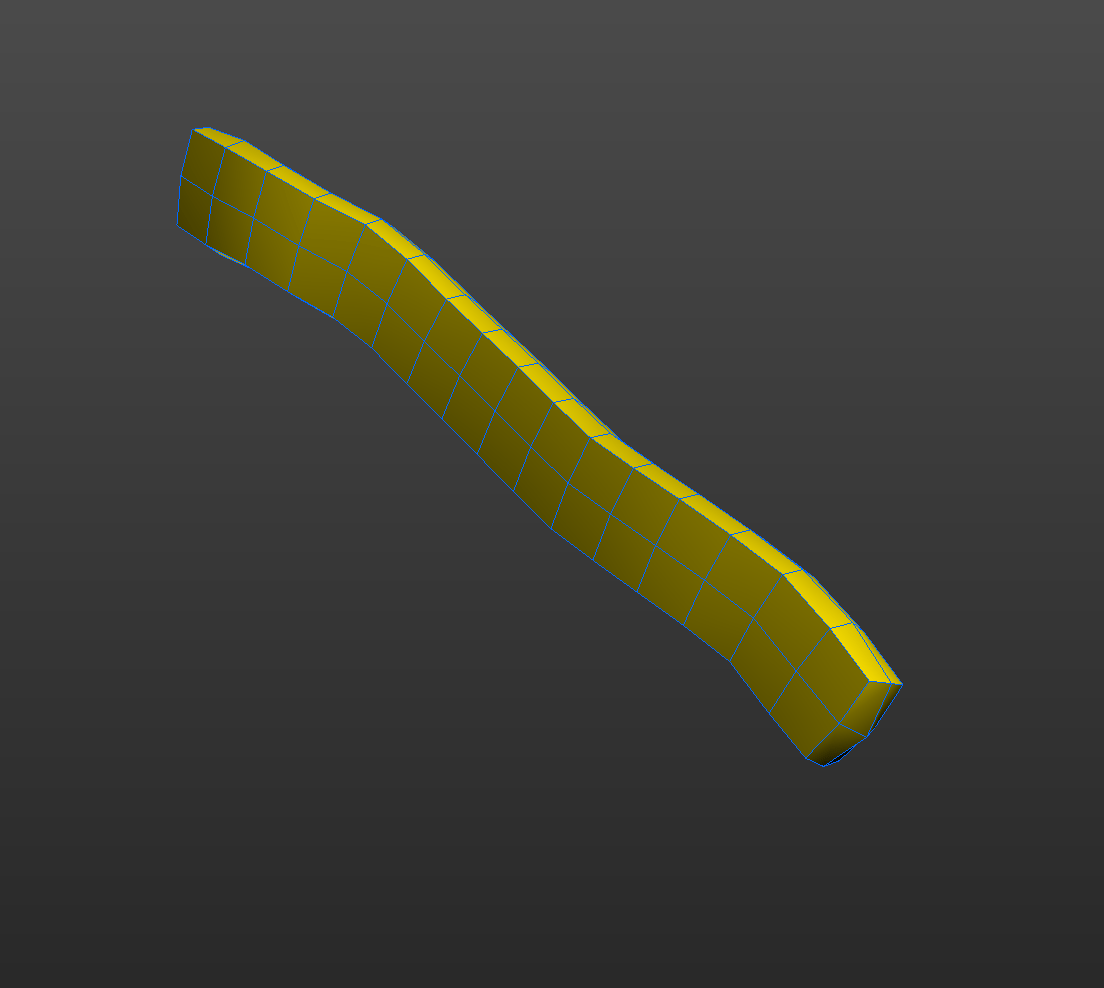

> 10. Depending on particle radius, mesh density, and inflation/stretch settings, my meshes turn "spiky" at the start of the sim (every other vert seems to jut out from the mesh). This is incredibly hard to dial in and remove while keeping characteristics I wish to retain during the sim.
I guess it is related to the earlier question. I wonder if its because of particles or meshing. Sample scene would be appreciated.

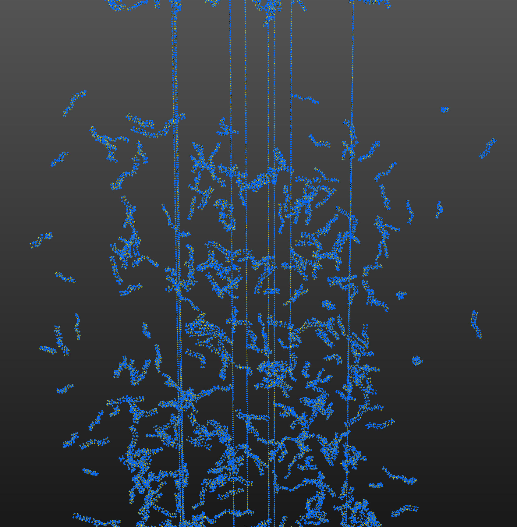

> 12. Is there a particle "kill" object type that I missed? Some of my particles don't all make it into the collider object, and the ability to trim them while still being able to save a cache to disk would be excellent. (vert number changes seem to invalidate the caches)
You can kill particles using standard approach in PFlow. We have it in one of our tutorial videos.

> 33. inflatable particles should have the ability to show their linked neighbors, etc. I realized one of my meshes had an issue when I tried switching to a softbody with small particles. There were "trails" of particles as if I had an edge connecting two of my mesh elements (top to bottom of my object.. was very strange). I didn't realize that was my problem until I tried that and saw the phantom particles, which I assume were also causing the inflatable setup issues, because once I scrubbed the geo and re-imported it, those issues went away. (see attached screen) I can confirm there was nothing connecting the meshes, and the vertex order was rebuilt with the same result.
Ok, so you propose we display not just particles but also connections between them, right? I think it is a good idea.
