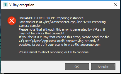

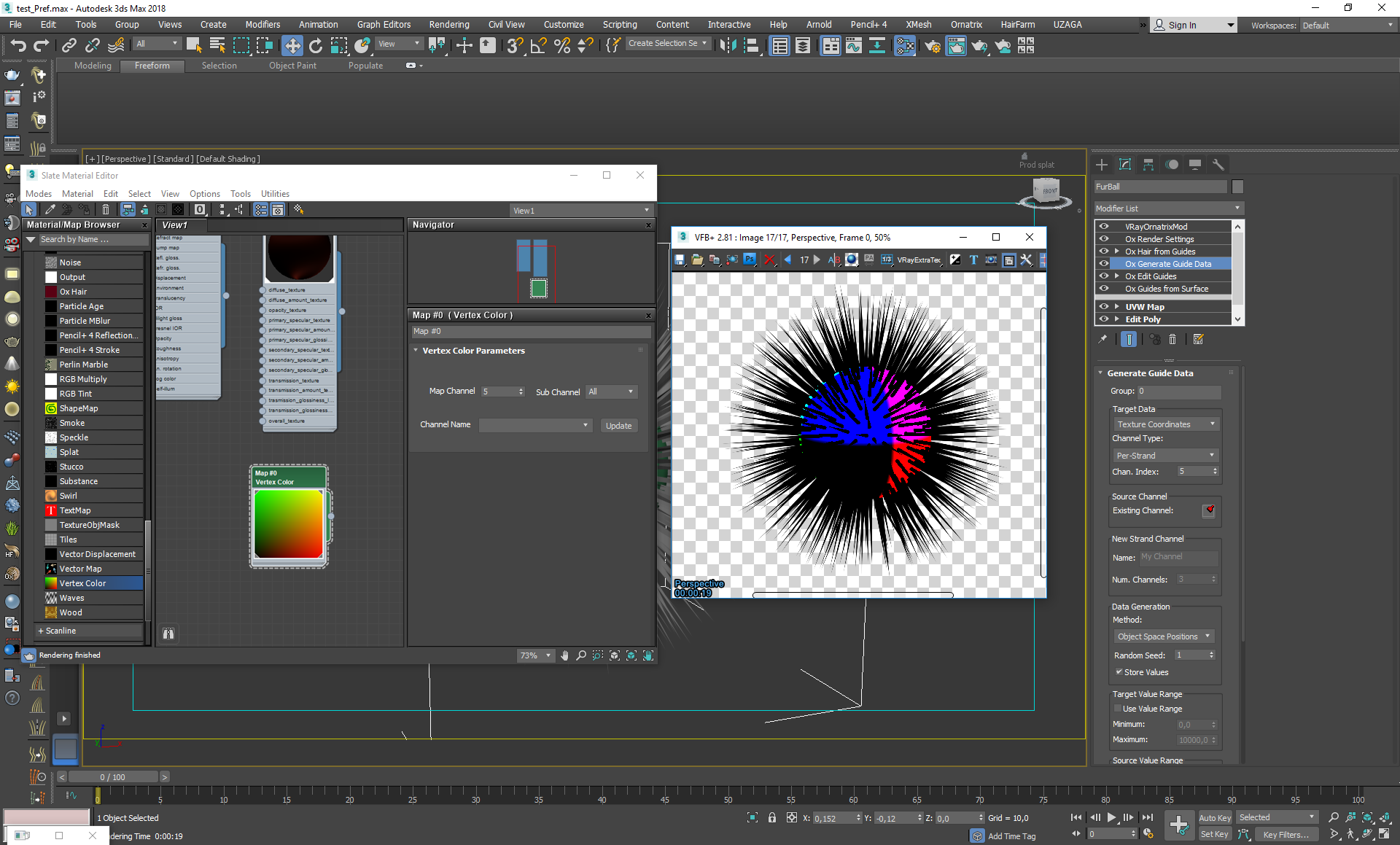

I followed all steps but when I changed channel map to more than 2 (I would like 5), Vray send me an error and stop render. If I set channel 1, I just have a uv pass on render (even if I set channel 1 in the vertex color node,
and same thing if I set channel 2). The only time I had a good Pref was when I set channel map to 0.
About the vray issue, if I move the Generate Guide Data modifier under the Hair from Guide it's rendering ! But same as start, the fur is totally black.
Is Ornatrix only override channel map 0 ?
I joined some of the results I had and the Vray error !
