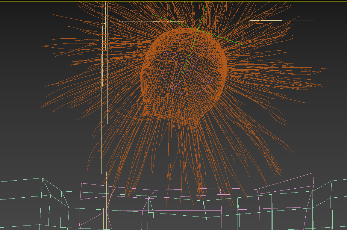

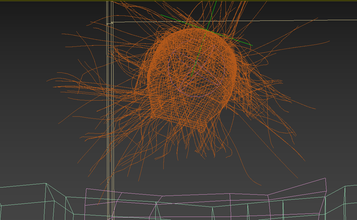

| I have gotten back onto this problem this morning. I noticed that curiously when I re-opened my saved scene, the cache is now displaying correctly! The crash behaviour is still there, but at least I have somewhat of a workaround. Every time I run a new sim, I can reload the scene to see what it looks like. [EDIT] Looks like I spoke too soon. Hitting render seems to re-scramble the cache. I've attached some screenshots of before and after and also my mod stack. |

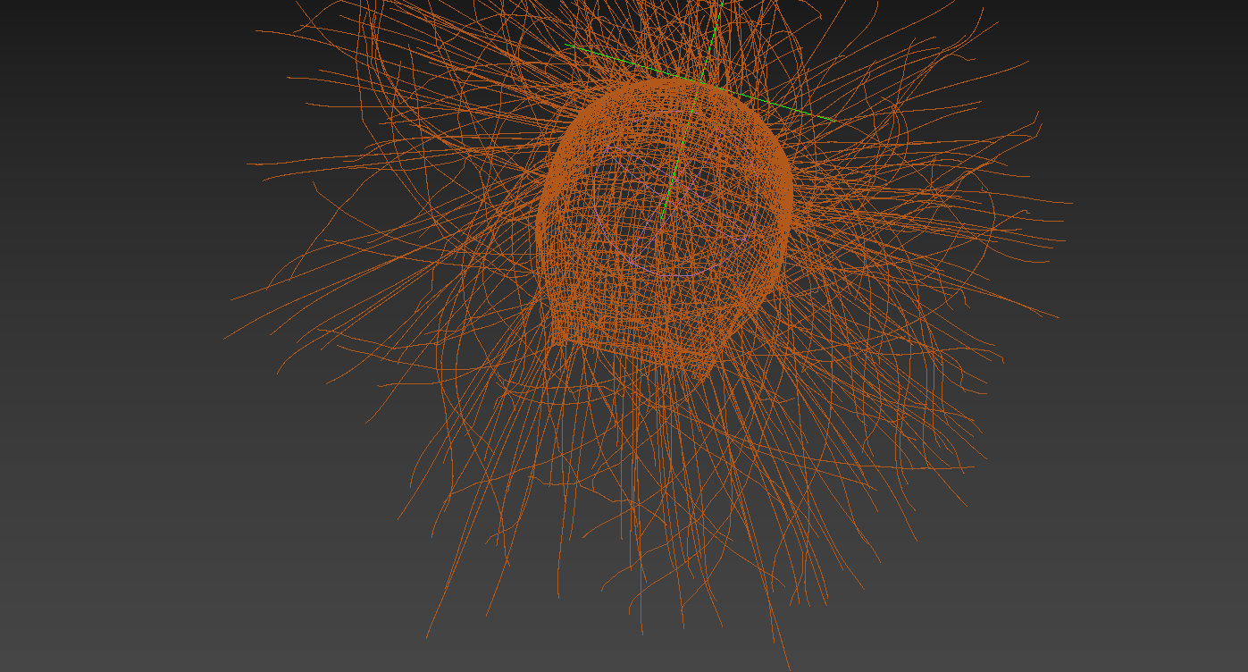

| I have installed the nightly from 5 hours ago. I recorded a new cache, and then as soon as I turn off the moov modifier it goes scrambled again. You can see in the attached screenshot what mine looks like. Your GIF looks correct. I wionder, can you send me your good cache file? That will let me know if the problem is in the reading or the writing of the cache. As a separate matter, can you try something for me? Load the scene, with the moov modifier active, click on the last frame. It will ask you if you want to compute 127 frames or something. If I say no, Max crashes. Thanks for your continued assistance. Attached Files: |
