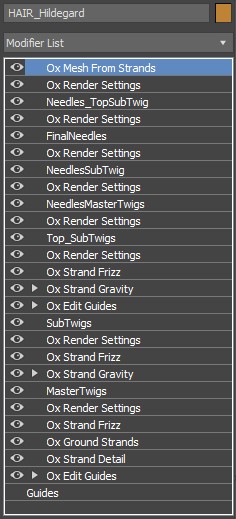

Hi there, I'm having problems rendering my strands. I've created a setup with several propagations on a mesh, which is skin wrapped to the main render mesh of a character which is an alembic cache. In the viewport everything looks fine, the strands move with the object. When I'm rendering a single frame, the strands are also in the right position and move along with the mesh. If I'm rendering a sequence though, the strands just stay in place, while the rest of the character moves. Can anyone help me? I've also attached a screenshot of the stack. Thank you :) Marco |
| Hey again. After trying different things I found that this might be a bug. Everything works fine, UNTIL I'm adding the first propagation layer. The Strands are not movieng along with the geometry anymore. Is there anything we can do to fix this? Thank you :) |

| Hi Jeordanis, here is the screenshot of the stack. In cas you still need it. Cheers, Marco Attached Files: |
