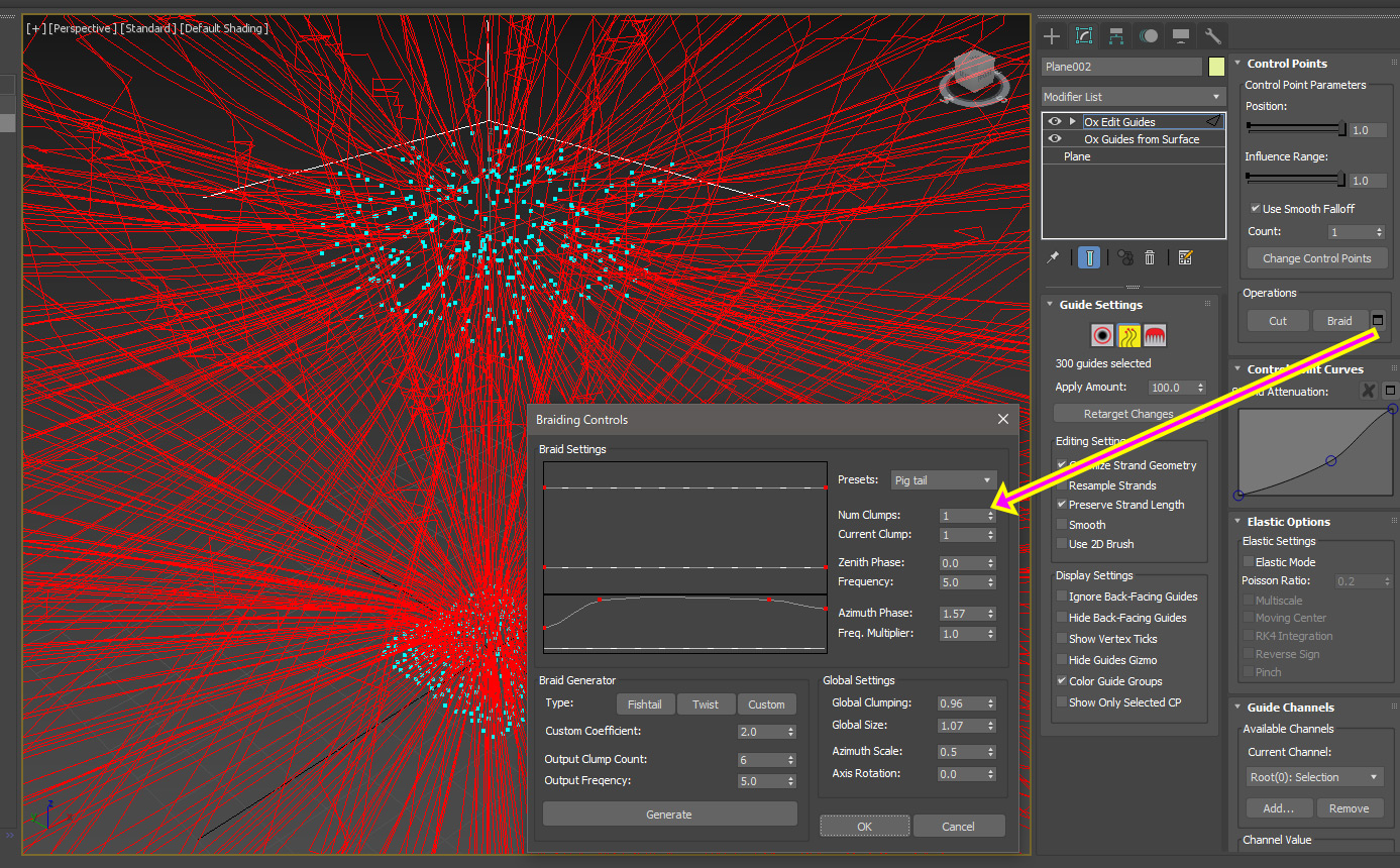

In Ornatrix 6.3.5.24029, operating the Braid Controls panel in Ox Edit Guides causes hair to explode.
Please Fix.

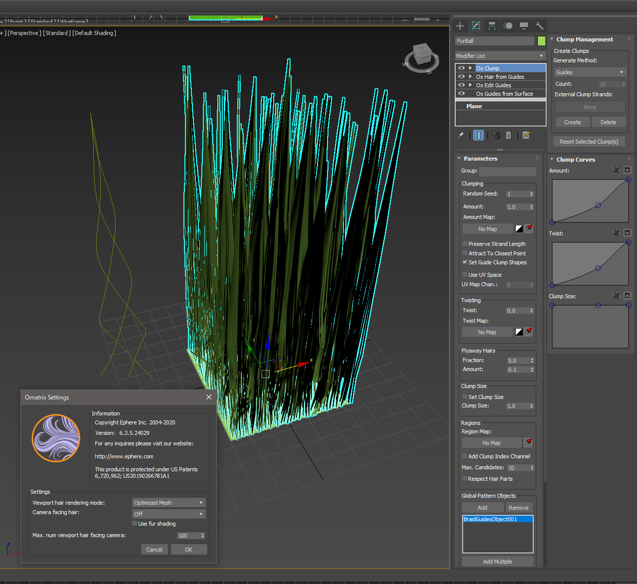

Also, the new Clump Modifier and Braid Object don't work well.
Is there a reference scene of 3ds Max using Clump Modifier and Braid Object?
The braid controls in Edit Guides are deprecated and not supported anymore.
What problems are you having with Clump modifier and Braid object, can you give me an example?
Hello, Jeordanis
Upload the scene.
What am i doing wrong.
>Clump_braid_max2020.zip (168234 bytes),
Thank you for the scene. I will take a look and get back to you as soon as I can.
I think it's a very simple check, but is it time consuming?
If it is a issue, please correct it.
I found an issue that I'm still investigating. I will keep updated with any progress on this issue.

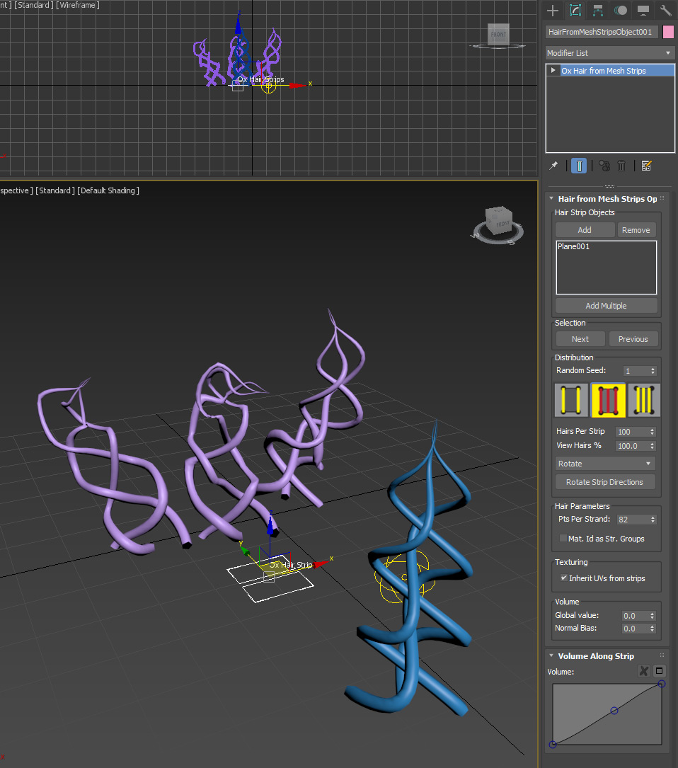

As a workaround you can create braids using Hair from Mesh Strips as I show here. This is for Maya but the same steps can be performed in Max.
Thanks for the reference video. This is another method.
But I tried this method in 3ds Max and HairFromMeshStripsObject001 doesn't generate hair from ProxyMesh.
tested Max scene.
https://drive.google.com/file/d/1XQHXmleW1PI-5j_i2UcR-0RgJibvs-La/
I see, this is a bug, we are looking into it. i will keep you posted.

We determined that this is a limitation for Ornatrix V6. This limitation has been resolved on V7.
