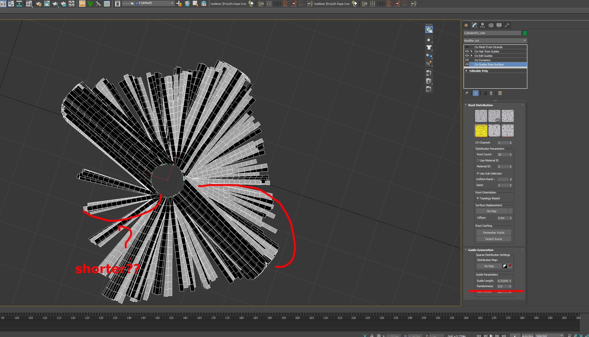

Do you have any tutorials to create car wash brushes? Thanks
OK.  I think i kind of know how to but why hair guides  have different legnths even though random is 0.  Thanks
I attached the scene
>vvvvvv.max (643072 bytes),
In a spherical surface like that maybe you don't have enough guides for proper hair interpolation. Try increasing the guide count.
