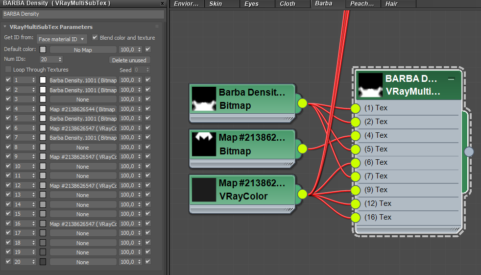

I have a character with multy UDIM, the scene is in Max 2021 and rendered in Vray next 3.2.

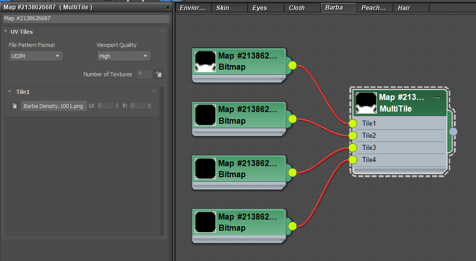

I would like to add a painted map (as density and Length) for building a Beard, the painting goes over 2 UDIM, unfortunatly I'm not able to make 3DSMax read the different Udim (only one was readed.

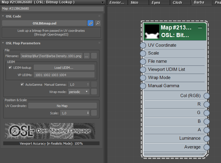

I tried different solution, Vray multysubtexture, Multy tile and OSL bitmap Lookup, I named the texture with the UDIM suffix (texture name.UDIM NUMBER.format), but seams that not works.

I just tried with a mesh with four UV tiles and a MultiTile node in Max 2019. It seems to be working fine here with Ox modifiers. In this test is connected to Ox Stand length modifier. See image below.
I loaded the maps using these instructions:
https://knowledge.autodesk.com/support/3ds-max/learn-explore/caas/CloudHelp/cloudhelp/2017/ENU/3DSMax/files/GUID-581886FF-437E-47AE-8B56-C76C129F54F3-htm.html
That's works fine!
Really thanks for support
That works fine. Thanks.
