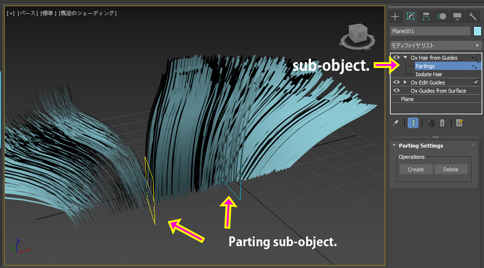

Request from our users, request an On/Off switch for each Parting sub-object. Best wishes, ------- Yuji Yamauchi OakCorp Support |
| Hi, Do you mean the parting by group feature? Jeordanis Figuereo (Product Designer. EPHERE Inc.) |
| Basically in 3ds Max, the modifier sub-levels are called "Sub-Objects".
Therefore, the sub-object function that divides Ornatrix partitions refers to the function of the attached figure. |

| They want to be able to switch On/Off the individual parting planes? Jeordanis Figuereo (Product Designer. EPHERE Inc.) |
| Yes. That is a feature request. |
| Got it. I will discuss this with the team. Thanks. Jeordanis Figuereo (Product Designer. EPHERE Inc.) |
| Hi, How would this be useful for your users? Why not just delete a particular parting plane when is not needed? Jeordanis Figuereo (Product Designer. EPHERE Inc.) |

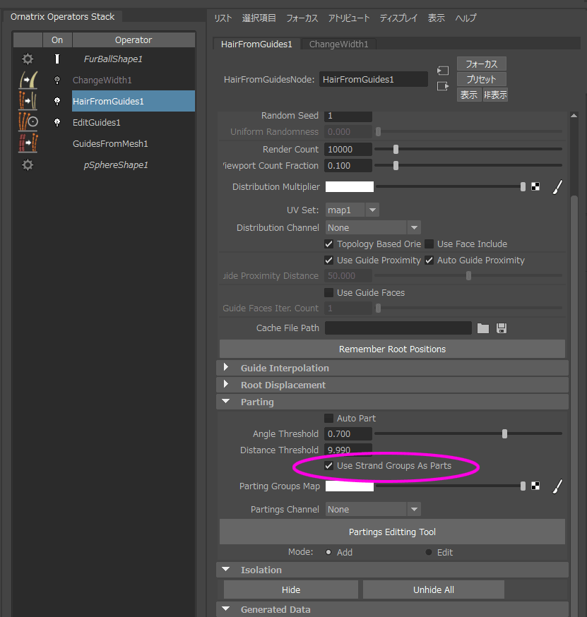

| This is because HairFromGuides cannot enable/disable the Strand Groups parting.
Why isn't the "Use Strand Groups As Parts" checkbox option in Ornatrix Maya in the Ornatrix 3ds Max version? Attached Files: |
| Oh I see. The parting by strand groups option is the default in Max but we will add an option to turn it off. Jeordanis Figuereo (Product Designer. EPHERE Inc.) |
