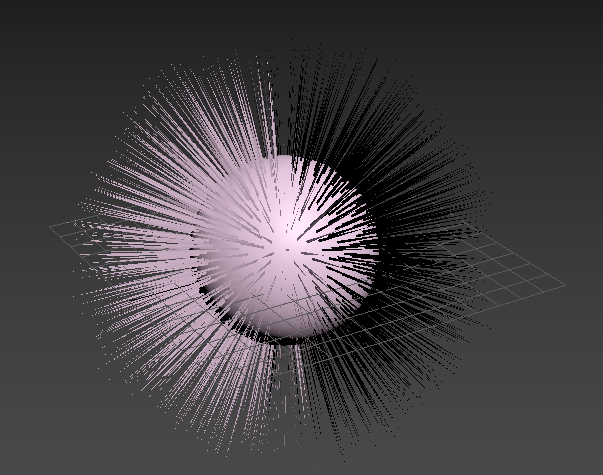

|  | Hi,
 no, it does it on a fresh scene too.
 Here's a sphere with quick hair applied, and then a surface comb added. V6 works, but V7 doesn't change the hair.
 Thanks,
 Steve

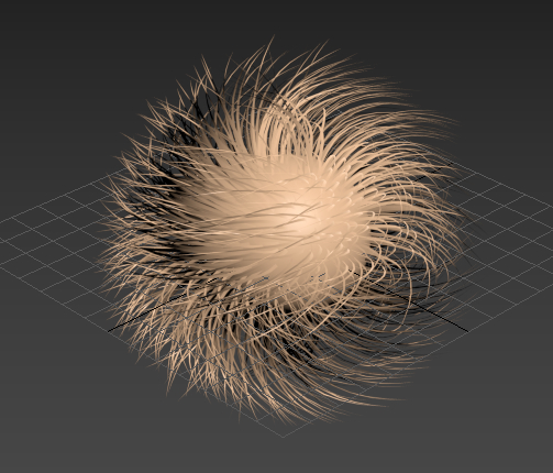

|  | Hi Steve, Can you try again with the latest nightly build? I believe this was fixed already. I just tried here and it works:
Jeordanis Figuereo (Product Designer. EPHERE Inc.) |
|  | Hi,
 no it's exactly the same - I noticed on your gif it doesn't do it either - if you don't add sinks it stays straight, where in v6 on mine if you didn't add sinks the default was it combed to the surface.
 Even if I do add sinks the min/max bend doesn't seem to do anything. In fact a lot of the settings don't seem to change much, e.g. Chaos (unless I'm missing something)
 Thanks,
 Steve
|  | Oh I understand now. Surface Comb modifier have a new algorithm to deform the strands. By default is set to the new algorithm, which behaves as I showed you in the gif above. You ca switch between the old and new algorithm in the Surface Comb Settings > Algorithm section, like in the following image:
 You are right about the parameters not working. We will look into that with high priority. Thanks! Jeordanis Figuereo (Product Designer. EPHERE Inc.) |
