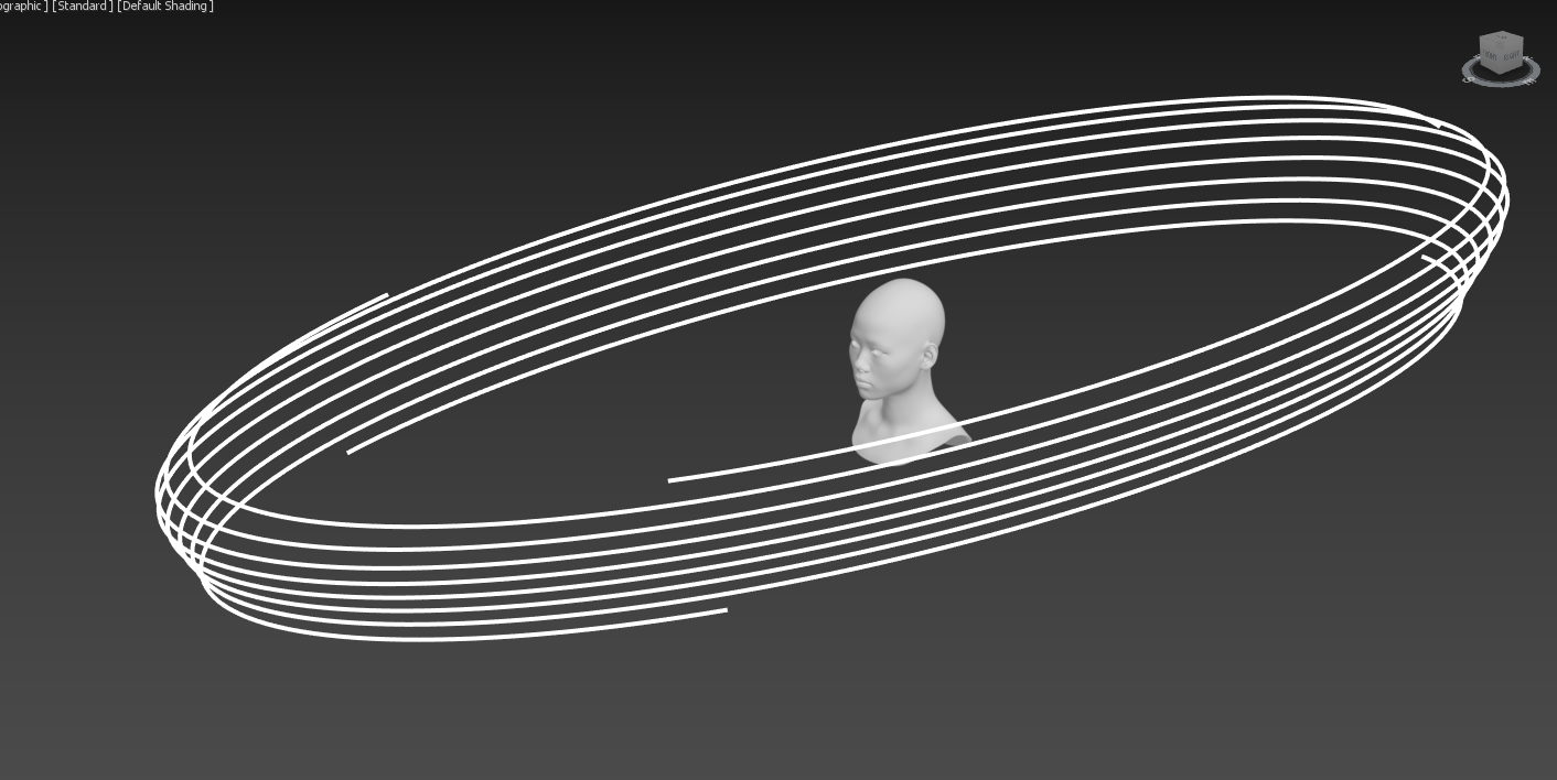

yeah I ended up using a clump pattern but as described above it often doesnt accurately represent the braid guide like in the below example

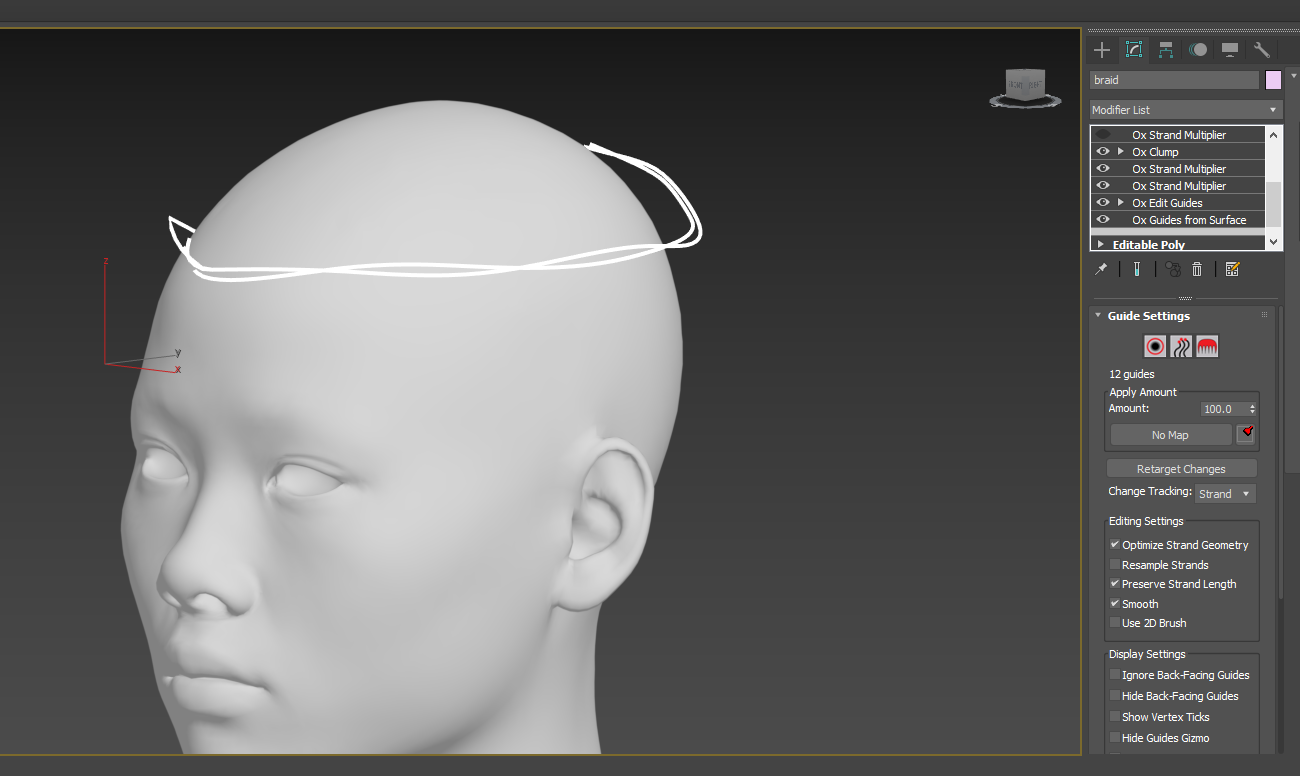

Awesome, thanks Jeordanis! Sorry for the late reply. Here's a few screenshots.
The circle surrounding the head is the Braid Guide that I'm using for this braid. I started with one hair guide and multiplied it

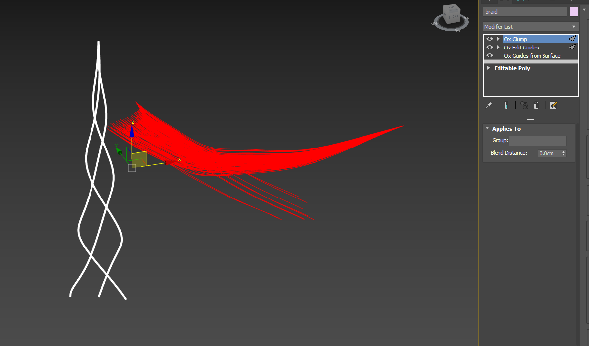

Strange, the images didnt come through above. I'll try again.
In the 3rd image I also tried with a fresh Braid Guide and fresh ox Clump modifier and this is what I ended up with (ox Clump is using External Clump Strands and the Clump is also loaded into Global Pattern Objects)
