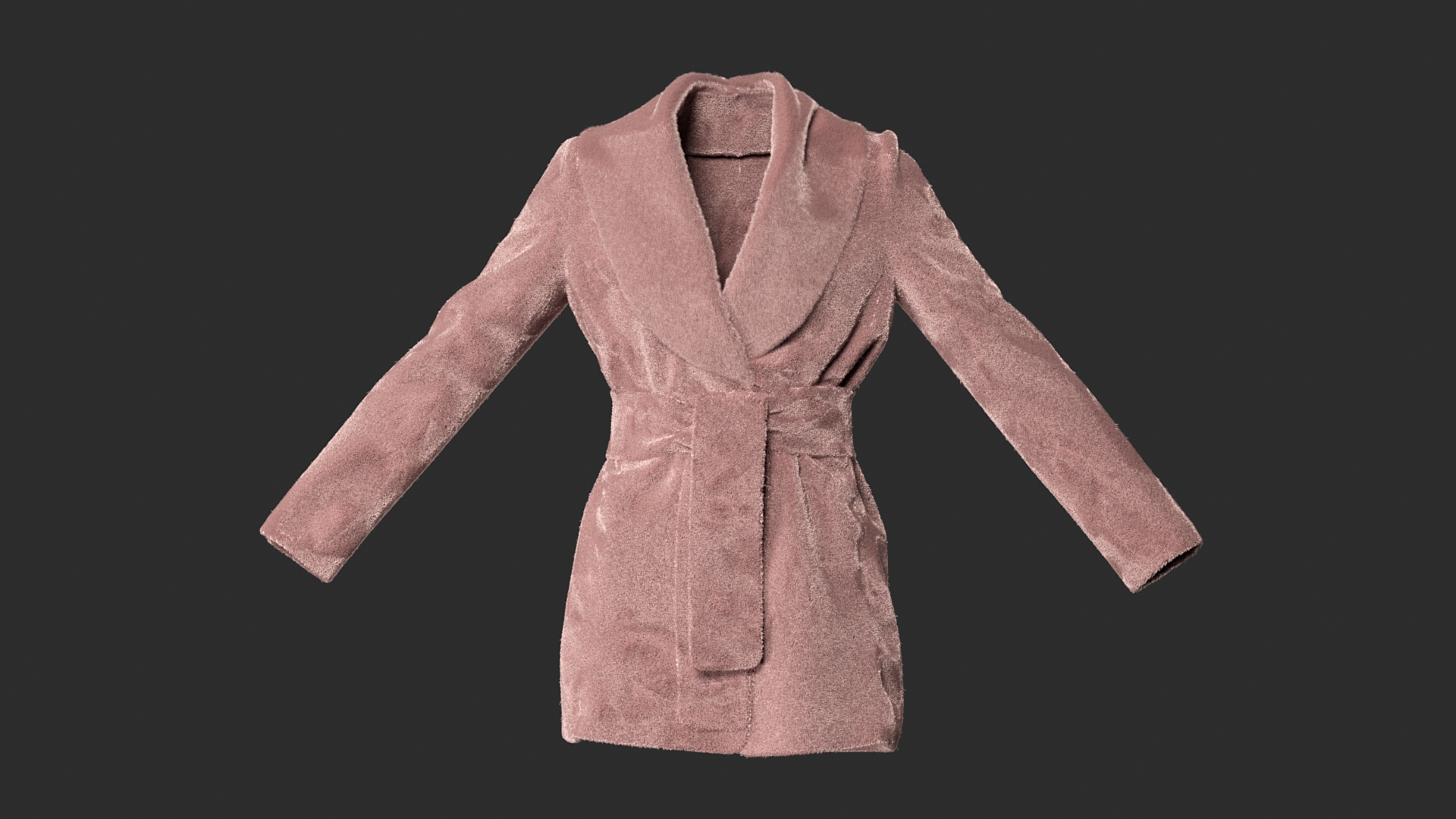

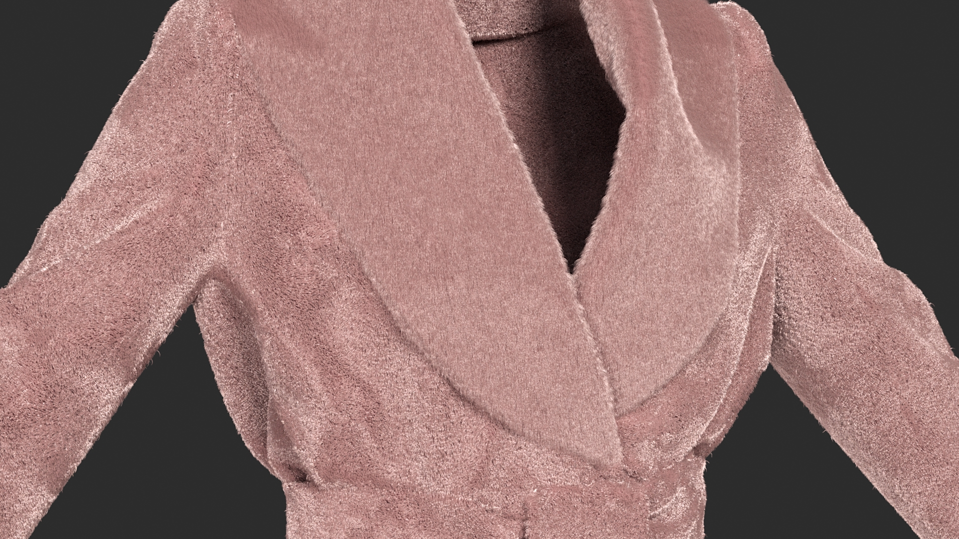

| The automatic reduction could be a last resort option. I need to keep the setup as simple as can be. I did get some good results using area distribution, but that is only on one single object (the one I send to you). I need to test multiple garments to see if this works. What I do run in to now is a memory issue. The garment I'm creating has a lot of dense fur (mink) and you can see from a close up that the coat actually isn't thick enough (filled up with dense hair). The jacket has 2 million hairs with times 6 multiplier modifier and that is without the collar taken into account (different hair object). I actually need it to have even thinner hair en more of it but as we speak Corona is swapping almost 90 gb of ram. Any thoughts? What I mean with breaks is not that it crashes, more that the loading time and performance are that low that is becomes unusable. Attached Files:  |
