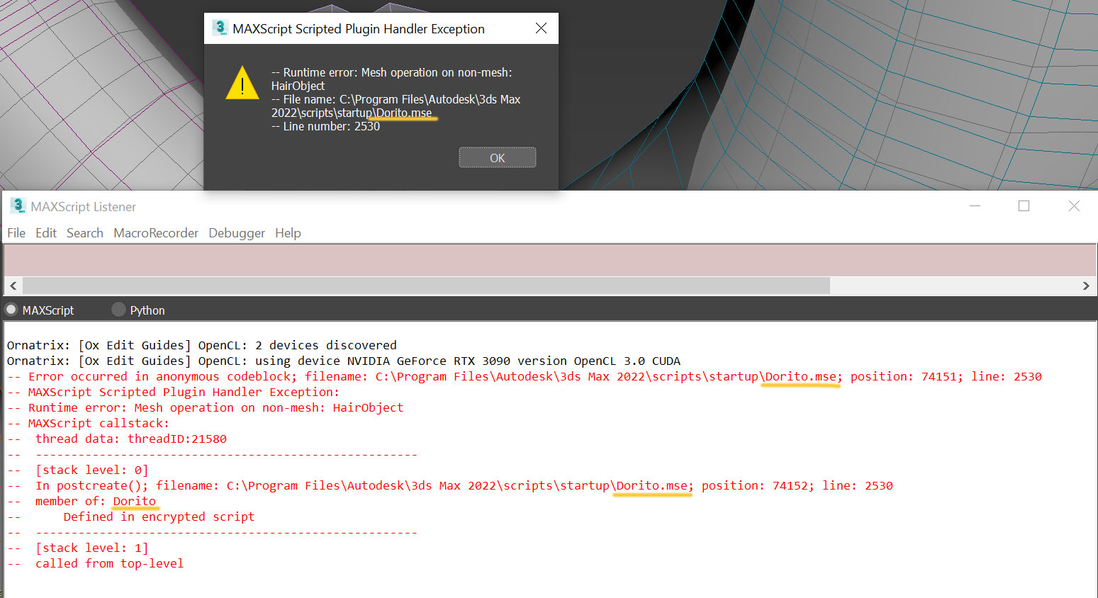

I attached screen capture in the attached file.
In Maxscript Listener it looks like a Dorito related message, but the exact moment this error message appears is when I try to adjust some options in Ornatrix.
I can't figure out if this is an Ornatrix problem or a Dorito problem.
Here is the version information of the program installed on my computer : Dorito 1.02, 3ds Max 2022.3, <strong><span>Ornatrix 7.3.4.29985, V-Ray 5.20.02.</span></strong>
For new test, I made a whole new scene and applied Ornatrix to a clean Sphere.
I did the same test 5 times, and the error message occurred twice among them.
Even with the same test, the error message is randomly generated.
Could you please give me any advice?
