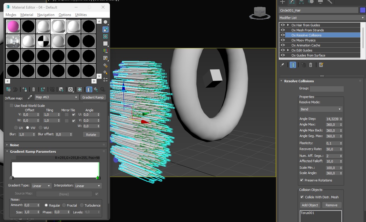

Hello, are you using Moov physics for the sim? Marsel Khadiyev (Software Developer, EPHERE Inc.) | |

It depends, what type of animation are you trying to achieve? Maybe you can get away with using the Oscillator, which is easier to control and faster than full hair simulation. Maybe I can give you some tips if you show me an example of what you are looking for.
To limit the movement with the animation or when combing with the brushes? You can tweak how a brush affects the hair using the BRush Attenuation and Strand Attenuation curves in Edit Guides > Brush Curves with a brush enabled. To limit the movement with Moov Physics you need to enable Attract to Initial Shape and play with its amount and curve value. The curve represents the effect from Root to Tip. Jeordanis Figuereo (Product Designer. EPHERE Inc.) | |

i havent found a solution for animationi cache tho..

You don't need to choose a channel necessarily. That is up to you. More info on strand channels here. It should work without choosing a channel. Please try with a fur ball on a sphere. If it works with fur ball in a new scene then I would need to look into your scene.
What problems do you have with the animation cache? Jeordanis Figuereo (Product Designer. EPHERE Inc.) | |
