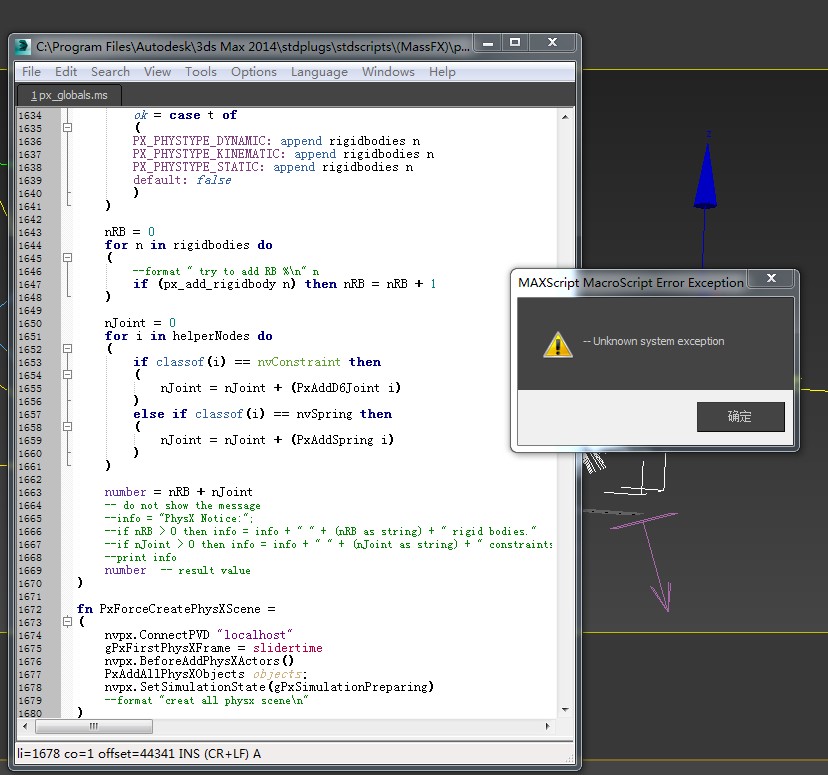

Hello, I use the latest Ox for 2013, I'm having trouble with Ox Dynamics. too. I want to make the horse's mane and tail with using ornatrix. 1.Problems arised when i simulated Ox Dynamics when making horse tail.During simulation, poped out many times “Unknown system exception”. 2. Every time I give a shape to the hair, but Ox Dynamics simulated is ugly, or can't simulate.I have to reset a scene can continue to calculate. 3. Sometimes I changed the parameters in Ox Dynamics, which had no effect on the hair simulation. your quick reply will be highly appreciated. Thanks mi | |

I would also check out the first dynamics video here: https://www.youtube.com/watch?v=h0U0rC53qXQ&feature=c4-overview&list=UUzzR4qt--4OcXgvyUTsgW6w
It goes over some of this issues you have like the MassFX script error and how to avoid it by having Dynamics at the top of the stack. Also check your scene size and scale. You can use MassFX visualization to see if your collision sizes are off. They can be adjusted with Wisp Size if they are very large or small.
Hope that helps Thanks Michael | |
