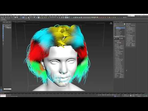

Hi, Any idea why paint hair color doesn't show up in the viewport?
Screenshot
https://prnt.sc/SyTVy0IppUmh here's the screenshot, I also followed this tutorial but it doesn't work for me ghuJtW3cjDM
What exact build of Ornatrix and 3ds Max version are you using?
3ds max 2020 and ornatrix 7
It works correctly on my tests. Are you setting the Channel Display option?
Or perhaps you have some viewport settings that I don't know about.
I added my test scene for you to try it. Let me know how it goes.

so it must some viewport setting cos it still doesn't show up. what viewport setting i should change to? i use standard viewport setting and haven't changed anything
Edged Faces causes a couple problems with Ornatrix hair display. That is the only setting(that I'm aware of) can could be causing this. Did you try my scene?
Yes I did but no result. idk what i'm doing wrong.

Can you try a different version of Max? Just to discard that as the cause.
Edit: Are you on the latest build of Ornatrix V7? The latest one is:7.4.1.31744 (24 November 2022).
Yes I am and for some reason it worked on 2021 which is fine. i want to know if there's any way to export the vertex color data to unreal engine and use it as an additional color information?

Hey, check if you have display mode set to Mesh in the Ornatrix settings. If so, switch it to Optimize.
Let me know how that goes.
ok i got back to max 2020 and set the display mode to optimized and it works now, thanks, also it'd be great if we have a feature to export the vertex color to unreal engine and mix with shader base color,
