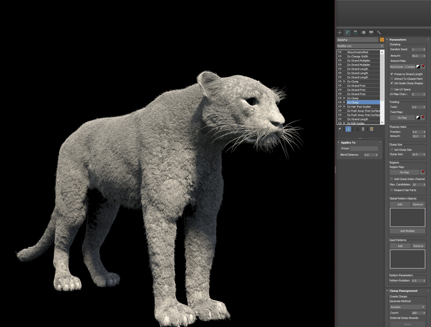

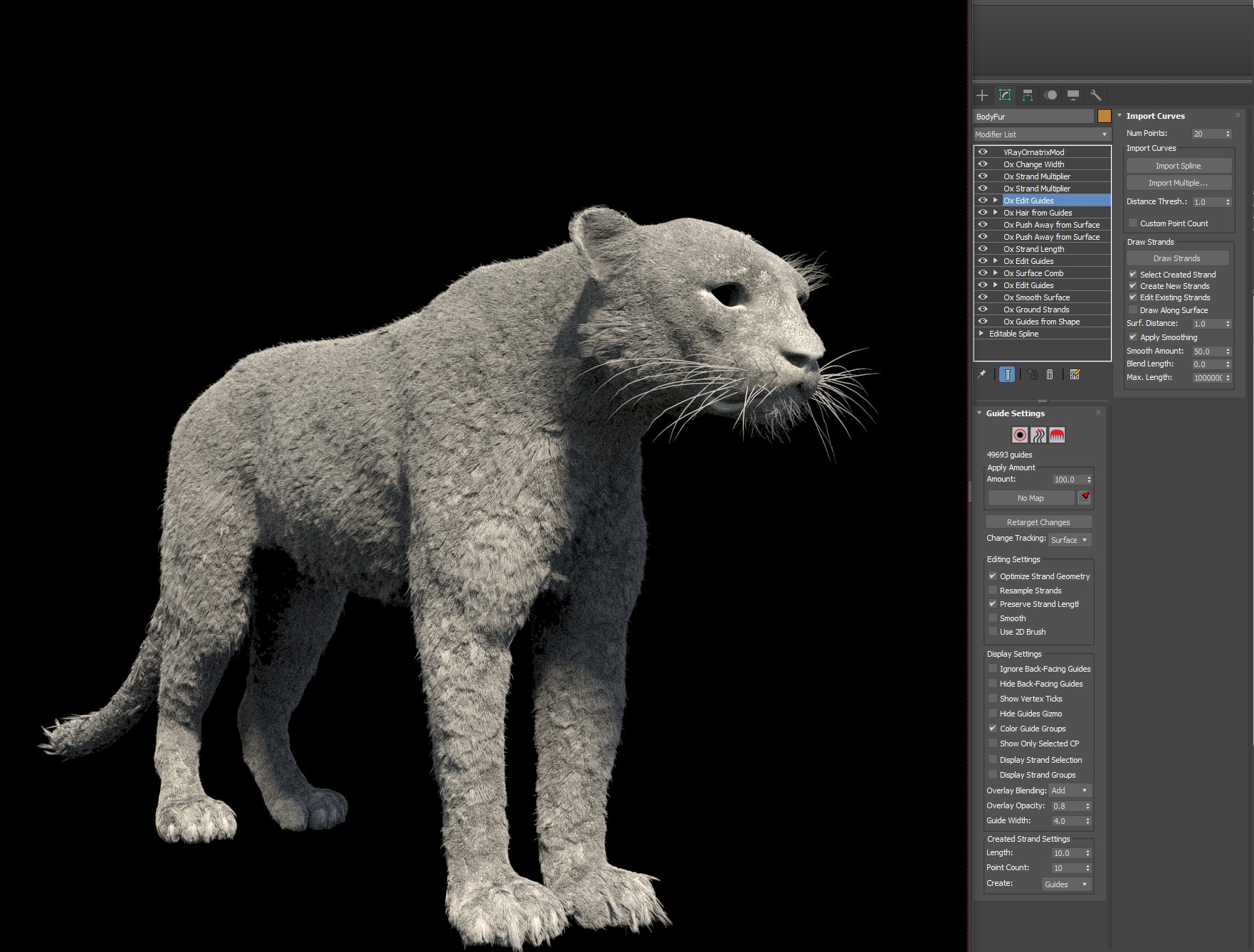

Also, when I bake the modifiers, it significantly changes the look of the fur
A specific modifier or any modifier?
I'm using Bake Modifiers from the menu as in that video. The reason it took longer seems to be because I baked Strand Multiplier modifiers
When I bake Clump, Strand Frizz and Stran Length modifiers, the grooming changes. I attached before and after renders
