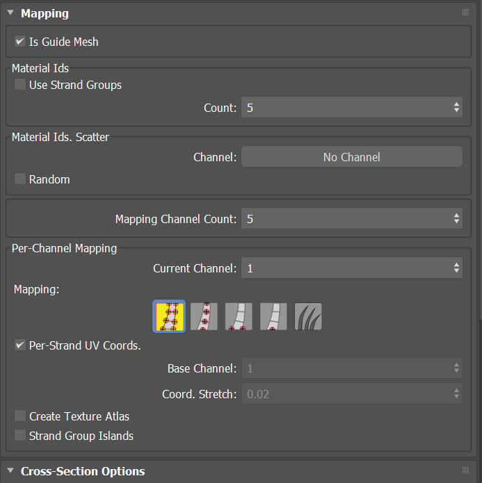

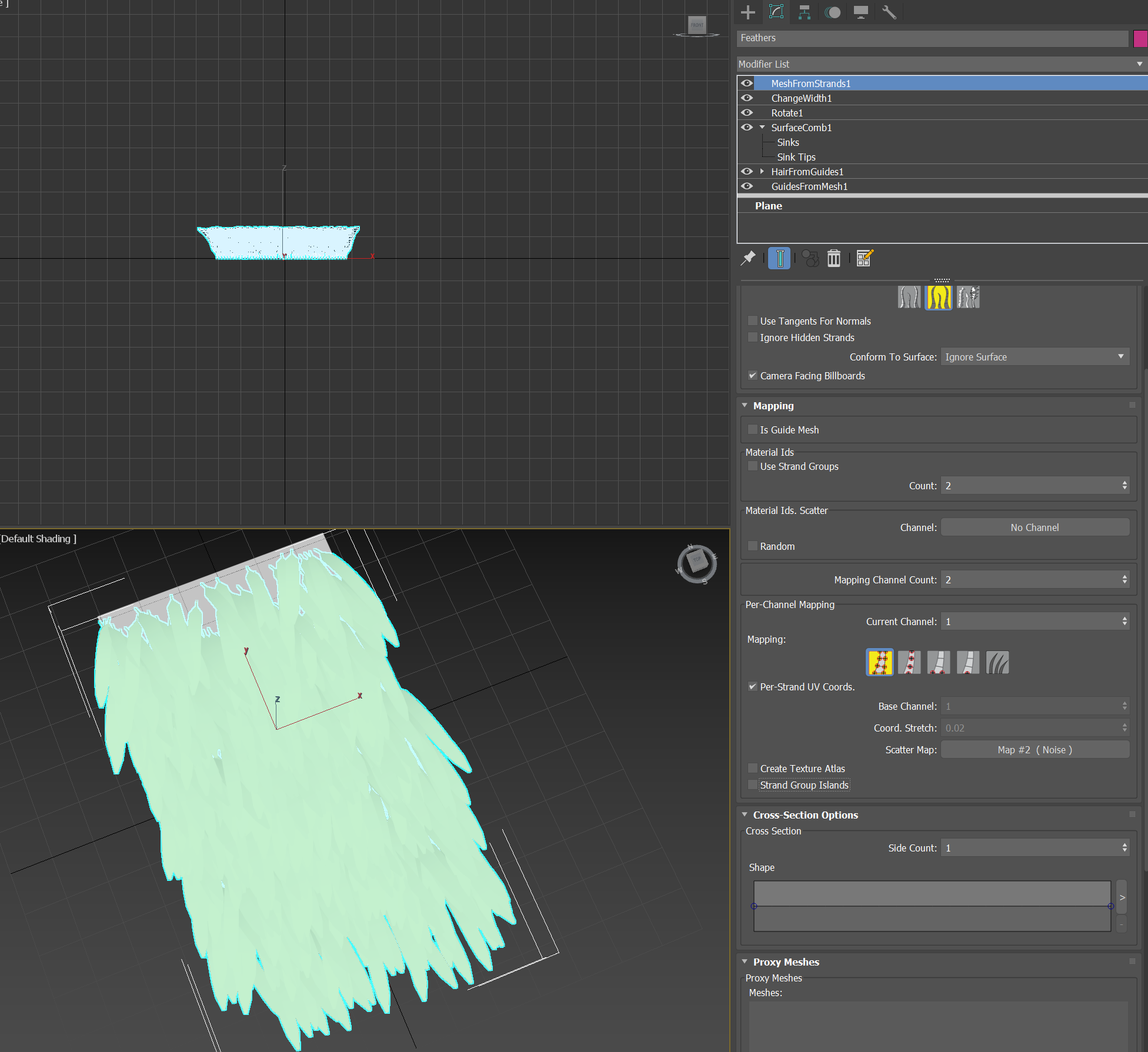

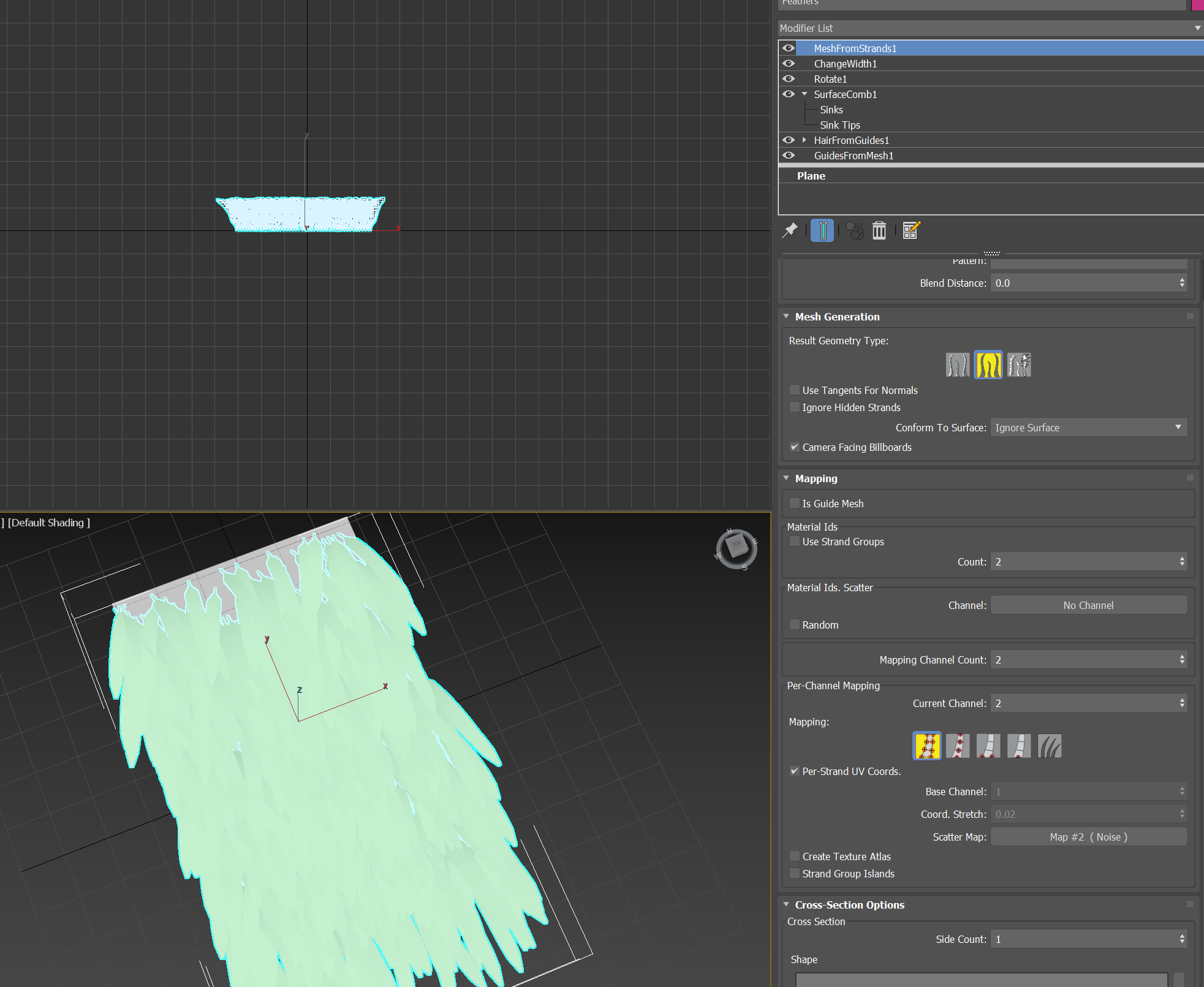

Sorry for the late reply, Just following up on this, the option is now present, but does not appear to function.
I did not test with revision 8.1.7.35298, but tested with 8.1.7.35310 and 8.1.7.35345 using both a texturemap and a procedural noise map.
Is there a option im missing, see attached.
I reinstalled version 7, and this option works as expected (also attached screenshot).
Note: in the ScatterMap_v8-1-7-35345.PNG image, "Current Channel" = 2, but tested with it being 1.
Kind regards.
>ScatterMap_v7-4-4-33124.PNG (382302 bytes), >ScatterMap_v8-1-7-35310.PNG (355706 bytes), >ScatterMap_v8-1-7-35345.PNG (330433 bytes), >Scatter_Map_01.max (393216 bytes),
