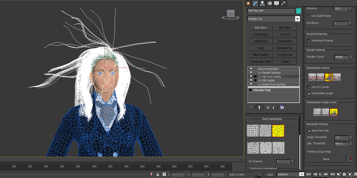

When I open a file I have worked on with Ornatrix, the hair is corrupted {see image}. Ornatrix 2.5.5.0 The hair was brush into position, some hairs were planted along the part then the hair was brushed. I have to start again . Attached Files: |
| I think this could be as a result of working with a file from 3.0 in 2.5. If you have done your original file in 3.0 and then gone back to 2.5 the brushing will not be retained properly. You may be able to bake the guides in 3.0 and then move back to 2.5. Thanks Michael |
| No I started a new setup from scratch. I'm using the same model but all the ornatrix mods are from 2.5? |
| Strange. Did you use the smooth brush at all? You can post the scene and we will have a look. If you can reproduce the issue with some steps that would be great. Thanks Michael |
| No! It was just brushed into position. It seems everytime I try and do something with Ornatrix I run into a bug. This wasn't cheap for what it is. I would have expected a more robust package. I seem to be sending you scene all the time. |
| You are using sub-selection to generate guides, so they will always be generated on the selected faces of the distribution mesh. You then changed the face selection and guides were re-created in just those selected face. To fix the problem: uncheck "Use Sub-Selection" in "Ox Guides From Surface" modifier. Marsel Khadiyev (Software Developer, EPHERE Inc.) |
