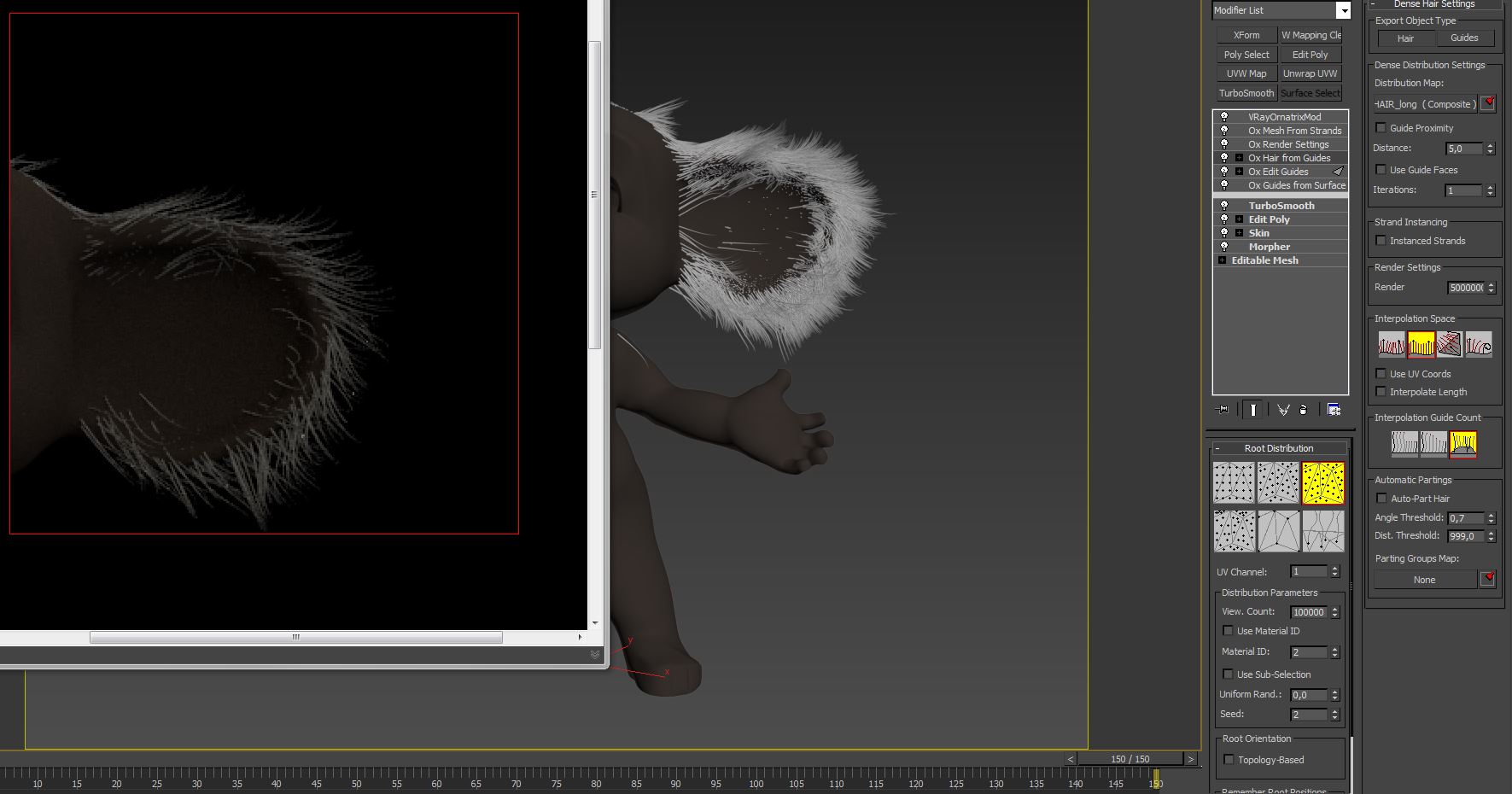

Hi everyone,
i get strange results when i try to render my hair setup (with the latest two OX-versions).
The hair-count from rendered area is different from the viewport.
A tip or help would be great.
Danny
Looks like there are a couple of things going on that I would change.
1. I would recomend removing Turbosmooth at the bottom of your stack. If it changes the topology it can mess up your groom.
2. Looks like you have Mesh From Strands below the Vray mod. I would recomend removing this for now to test your scene.
