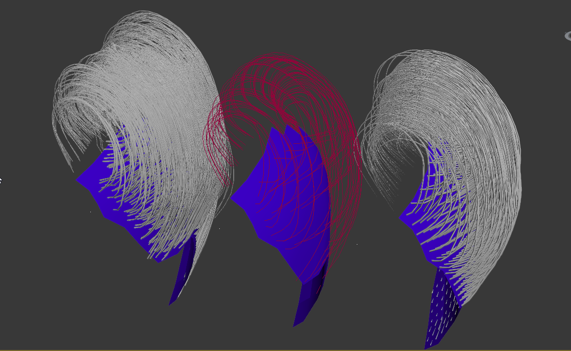

#5145 | |
I took at look at your next scene here. If you watch the video and do what I show there for the sides you can see you will get much better match to your guides. The image attached shows the difference with your hair on the left, your guides on in the middle and the result of working with the tips from the video on the right. Thanks Michael | |
