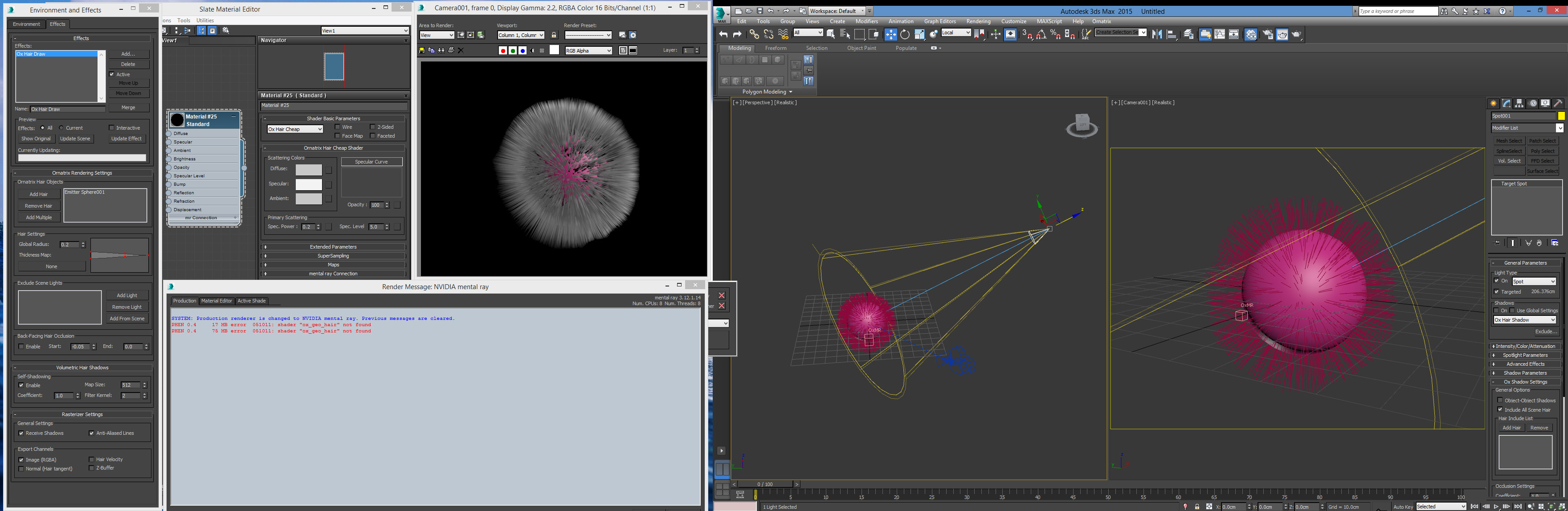

Hi
Thanks for the fast reply.  I have created the scene in the images posted on a completely new session of 3DS Max 2015.  It is a simple primitive sphere with Ornatrix hair assigned.  I have used Standard lights with Ox Hair Shadows assigned and MRHair primitive is placed in the scene with the hair assigned to it as 'Source Hair'.  I have also setup Ox Hair Draw effect to supply the hair thickness and profile.
Am I missing something, as I still get the error message for ox_geo_hair not found.  I also noticed the OrnaMR.dll was unable to load on startup of 3DS Max.  I am currently using the latest version of Ornatrix V2.5.8.0.  Hope you can help.
On another note could you also explain which shader network and shadow types for lights works best for Ornatrix hair in Mental Ray.  I would like to get the same quality as the Ornatrix standard shader, light shadows and buffer renderer provide but with Mental Ray so compositing is easier and more accurate in regards to lighting and shadows between objects and hair at the post production compositing stage.

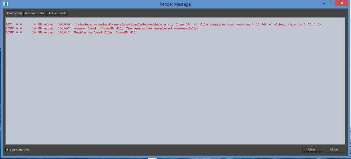

I have tried the suggestion on your last post and here are my findings
1. I already had OrnaMR.mi and OrnaMR.dll in the locations as suggested.
2. On booting up 3DS Max 2015 with a fresh scene the Mental Ray render error message states it cannot load OrnaMR.dll.  The full error message on opening a new 3DS session follows:
LINK 0.0  10MB error 191007: cannot load OrnaMR.dll, The operation completed successfully.
LINK 0.0  10MB error 191012: Unable to load OrnaMR.dll,
MI 0.0  10MB error 121417: rayrc, line 18: cannot find include file "OrnaMR.mi"
LINK 0.0  10MB error 191007: cannot load ./OrnaMR.dll, The operation completed successfully.
 3. After starting up a new session in 3DS Max I proceeded to create a Sphere, place the Ox MR primitive in the scene and assign the Ornatrix Hair in the scene to it.  I assigned a standard Material and Arch & Design on separate occasions and placed a Standard Spot Light in the scene for Mental Ray to show the object in render.  On render of both materials I see no sign of the hair only the emitter object.  I also recieve an error message each time I render stating the following:
PHEN 0.4  97MB error  051011: shader "ox_geo_hair" not found.
