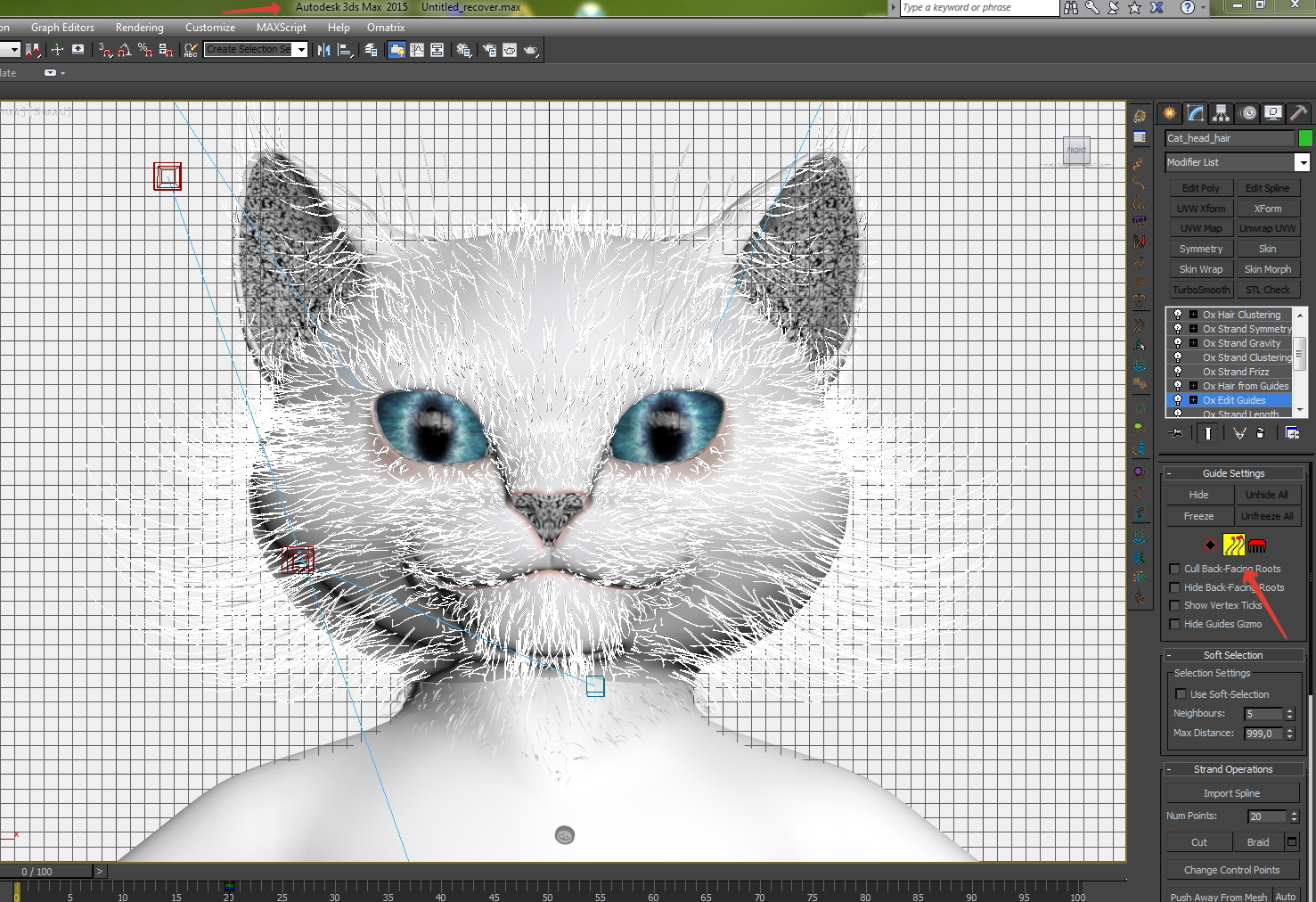

After you install the update plugin3.105 - disappeared guides I could not use the symmetry evenat max 2015, the program was closed with an error. Buton version 3105 I managed to make symmetry.But disappeared guidesfor the hair ,whichI did 3103version.
if I put 3103 version after3105 , then when editing guide3d max crashes
link
work stopped becauseI can't not work at 3105 not 3103
>Untitled_error_2015_v3105.max (1064960 bytes),
error 3105?
