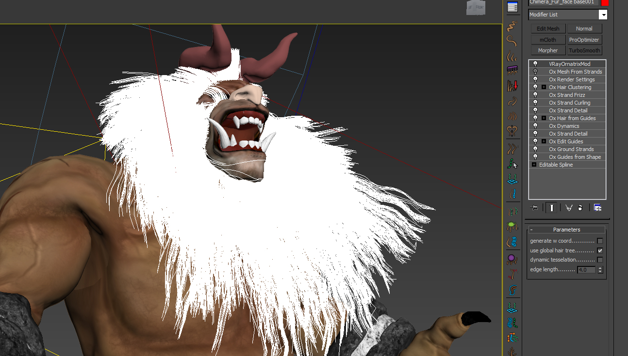

I tried to do network render Using OX Strand Detail, Line is stand up(spiky) like test
What is the matter?   ver.3.1.1.0

yes. If you use the OX Strand Detail
local, network is both
Try to put OX Strand Detail under the OX hair from guides.
So even if there is no change.
The only solution to disappear.
I had the same problem a few days ago and it was a solution.
Oh! Thank you. Has been solved!
Thank you for the solution ...
I have made a fix to Ox Strand Detail, please try it again in the next build
