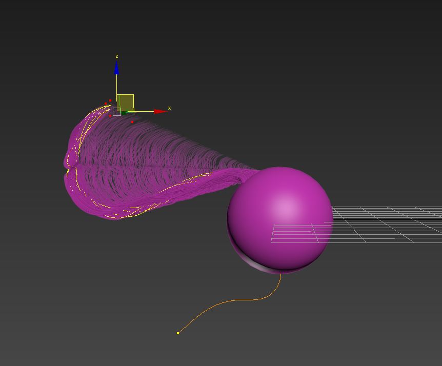

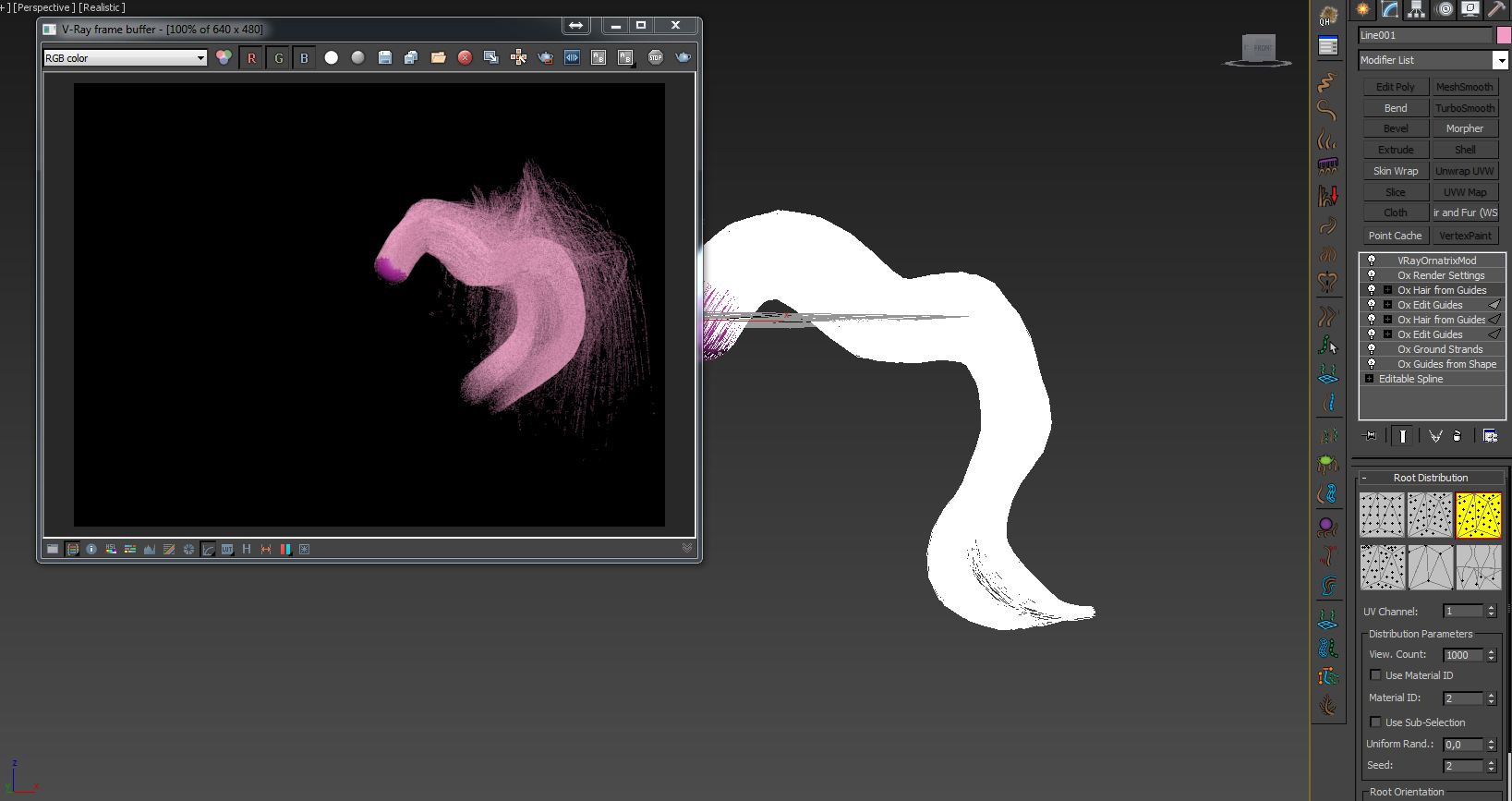

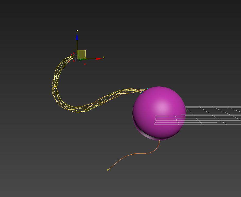

Hi Michael. Please see in attach two scenes. I have one more quastion. Can I attach tip (end of the hairs or even midlle) of the quides/hairs to some animated object? I know I can use shells but this cut my hairs. Any idea how I can do that? Thank you. Attached Files: ![]() ![]() ![]() ![]() ![]() | |

In Ornatrix1a.jpg you have some strange interpolation. In your scene it looks like this is do to the Strand Detail modifer. If you remove that it should look correct. I will investigate what is going on with Strand Detail.
Ornatrixq2.jpg seems to have a rendering issue. Your scene renders OK for me here. I might suggest updating to the latest version of Vray.
