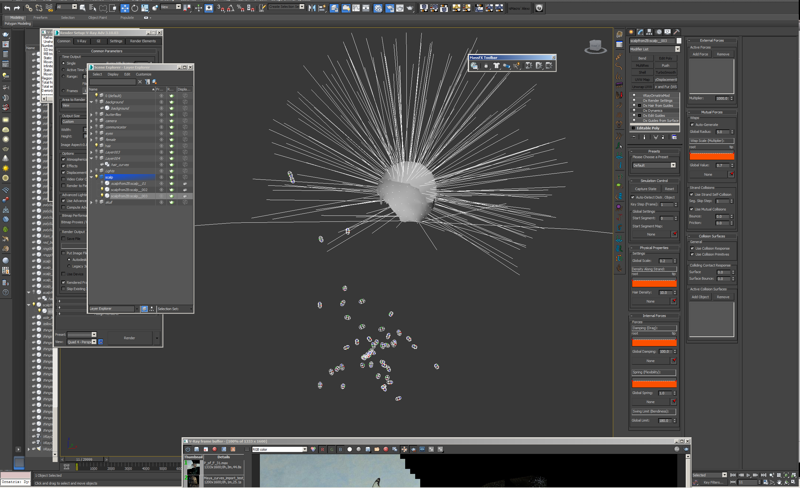

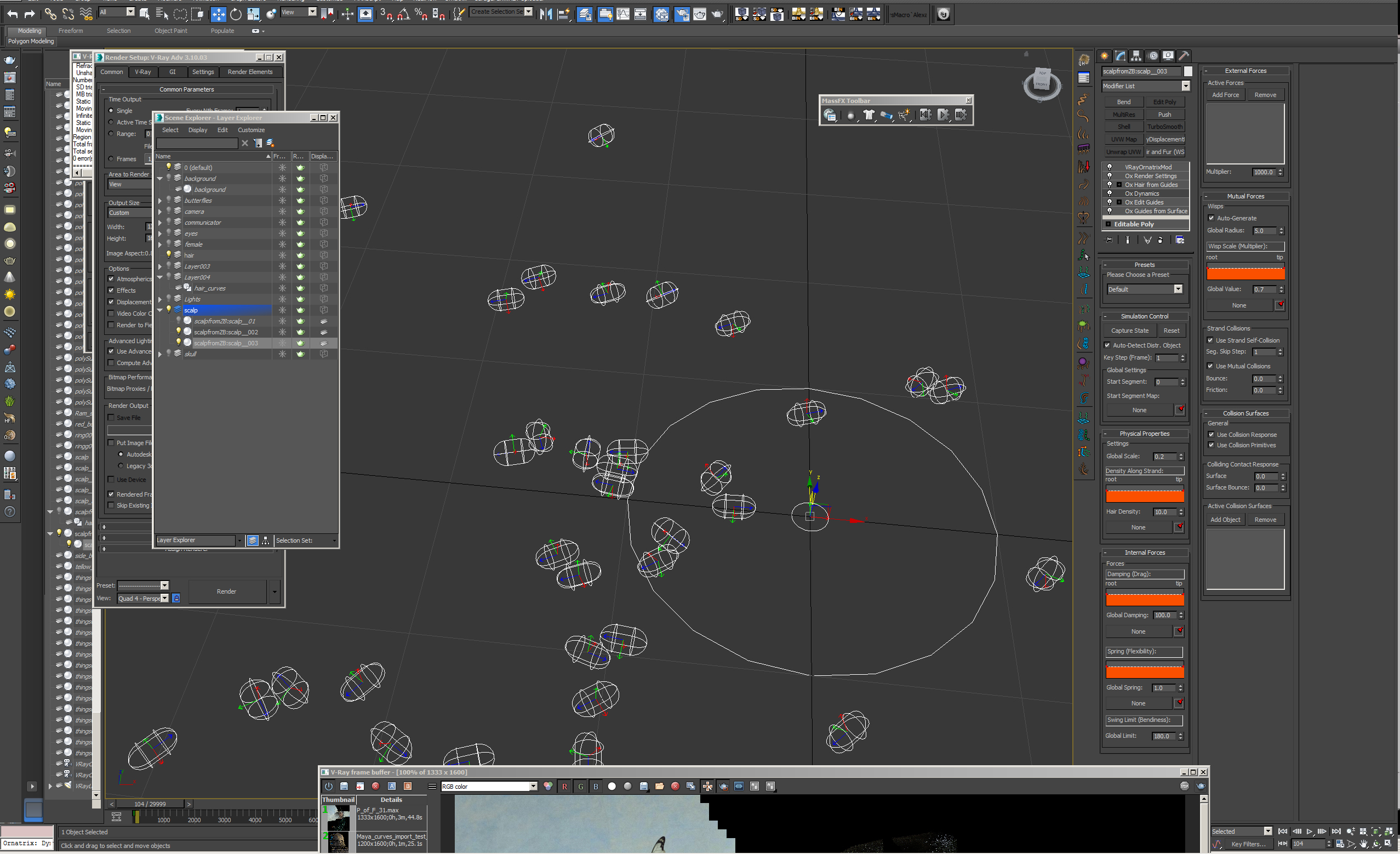

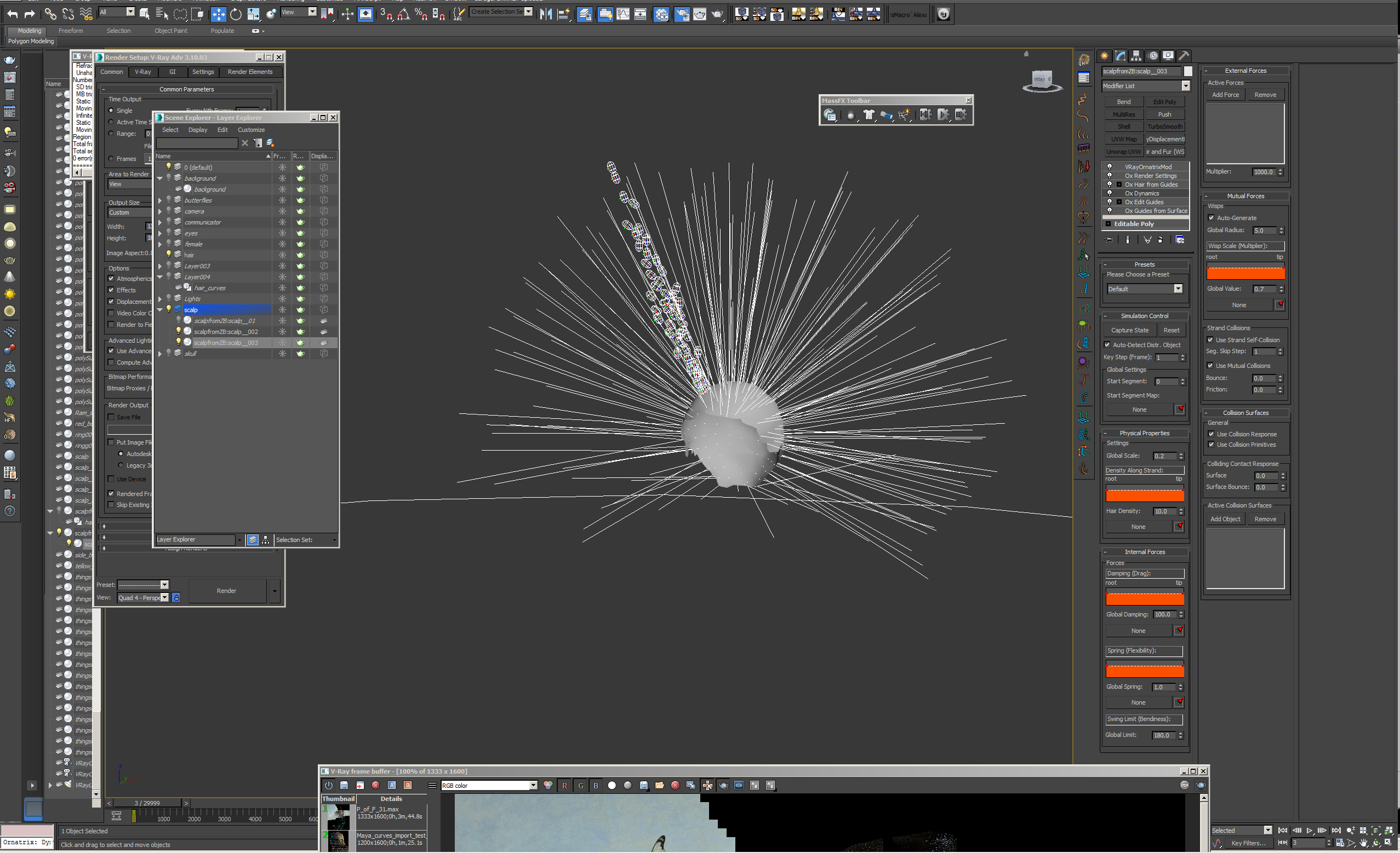

I have not had much success with the Ox Dynamics mod. I have only gotten it to work once or twice before, but I have no idea why. Tonight I tried turning on Enable Visualizer in the Mass FX Tools to see if I could better understand what is happening. The screen shots are what I saw. As soon as I hit play a line of these little capsule thingys show up on one of the guides and then they all fall to the ground plane and scatter. I don't know for sure, but I suspect this is what has been happening whenever I have tried to use the Ox Dynamics mod. John Brophy Fine Art www.jbrophy.com | |

Thank you for posting the screenshots. I suspect it is a scale issue. Could you also please post or send me the scene (marsel.khadiyev (at) ephere.com)? Marsel Khadiyev (Software Developer, EPHERE Inc.) | |

hi, I met the same problem u mentioned b4, and it had been bothering me for quite long time, unitl i just found the solution :D, if you turn on the massfx vusualize thing, just like u said, those capsules could fall down ,but if you increase the scale( 1 as defult), problem solved!! |
