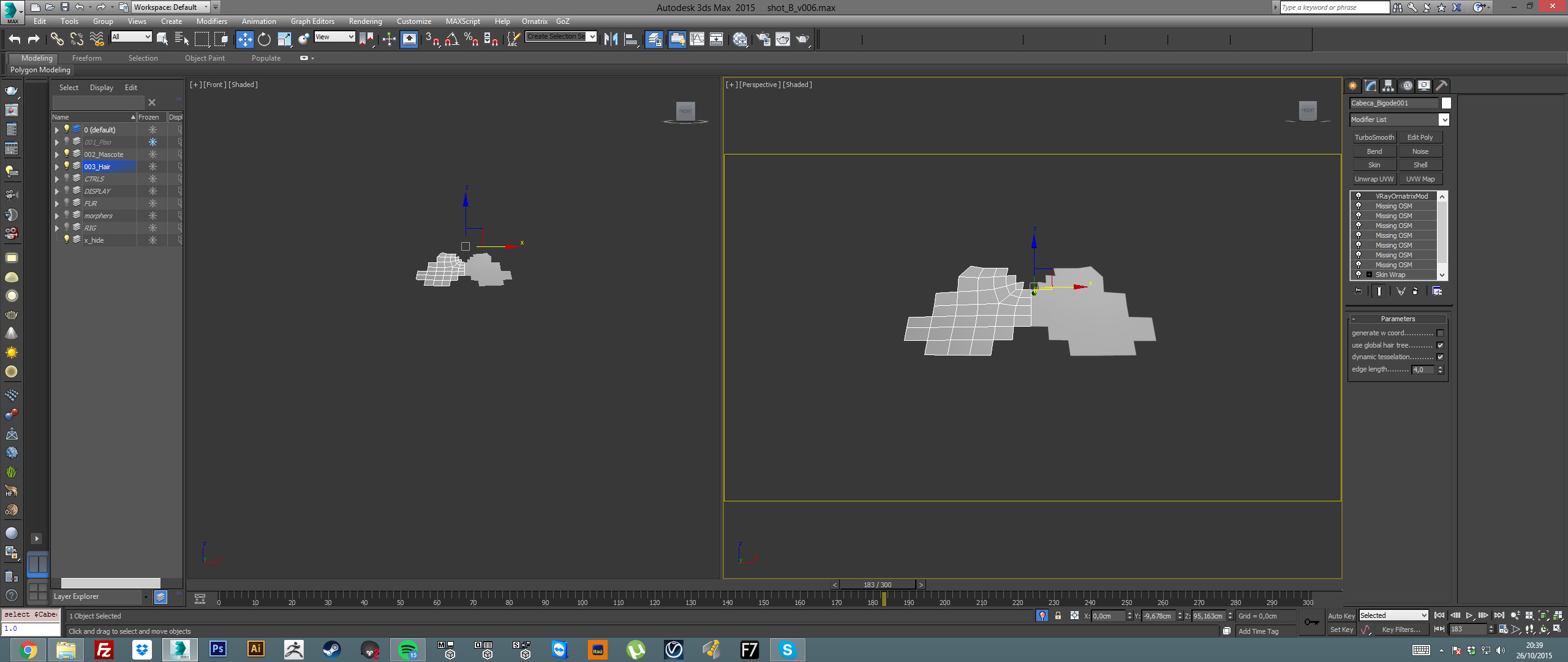

Just download the latest version of the site and installed. When I opened the file does not seem to have the most ornatrix.Help me :(
It looks like Ornatrix did not get installed. Do you have <3dsmax>/plugins/Ephere.Plugins.Autodesk.Max.Ornatrix.dlo file?
I installed the previous version and returned to normal.
Now I was on all machines and installed the same version and now works in the distributed rendering vray.
