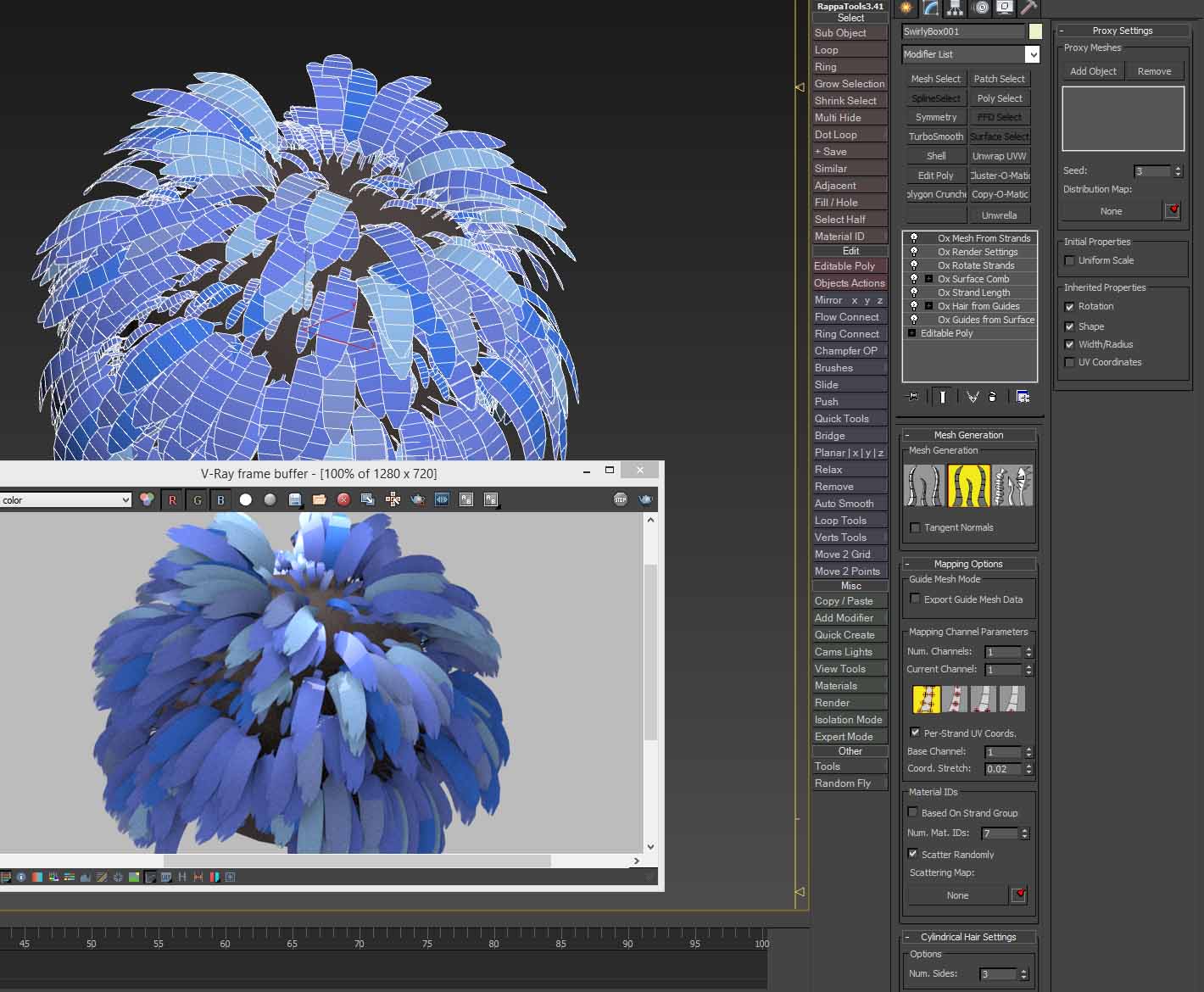

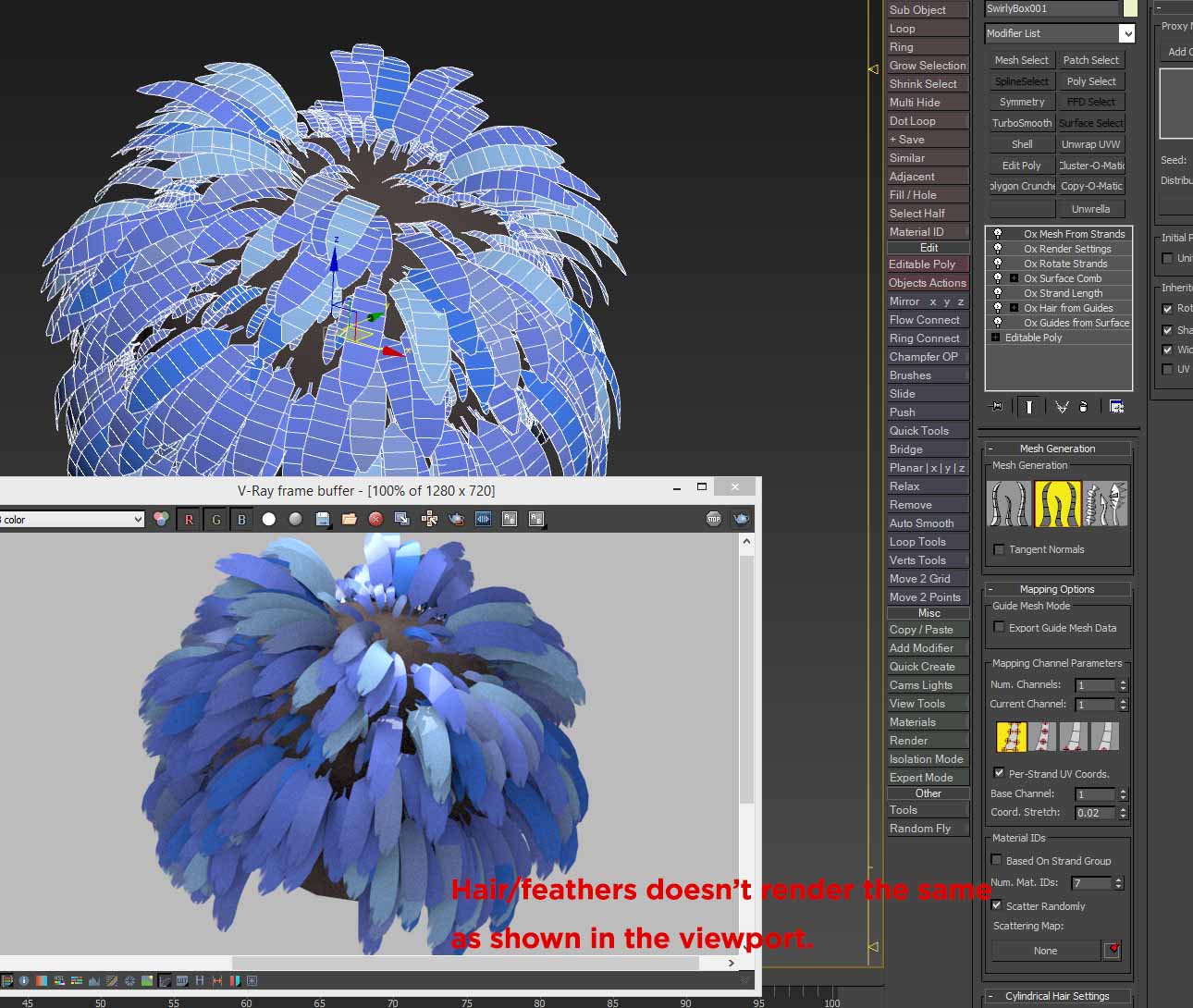

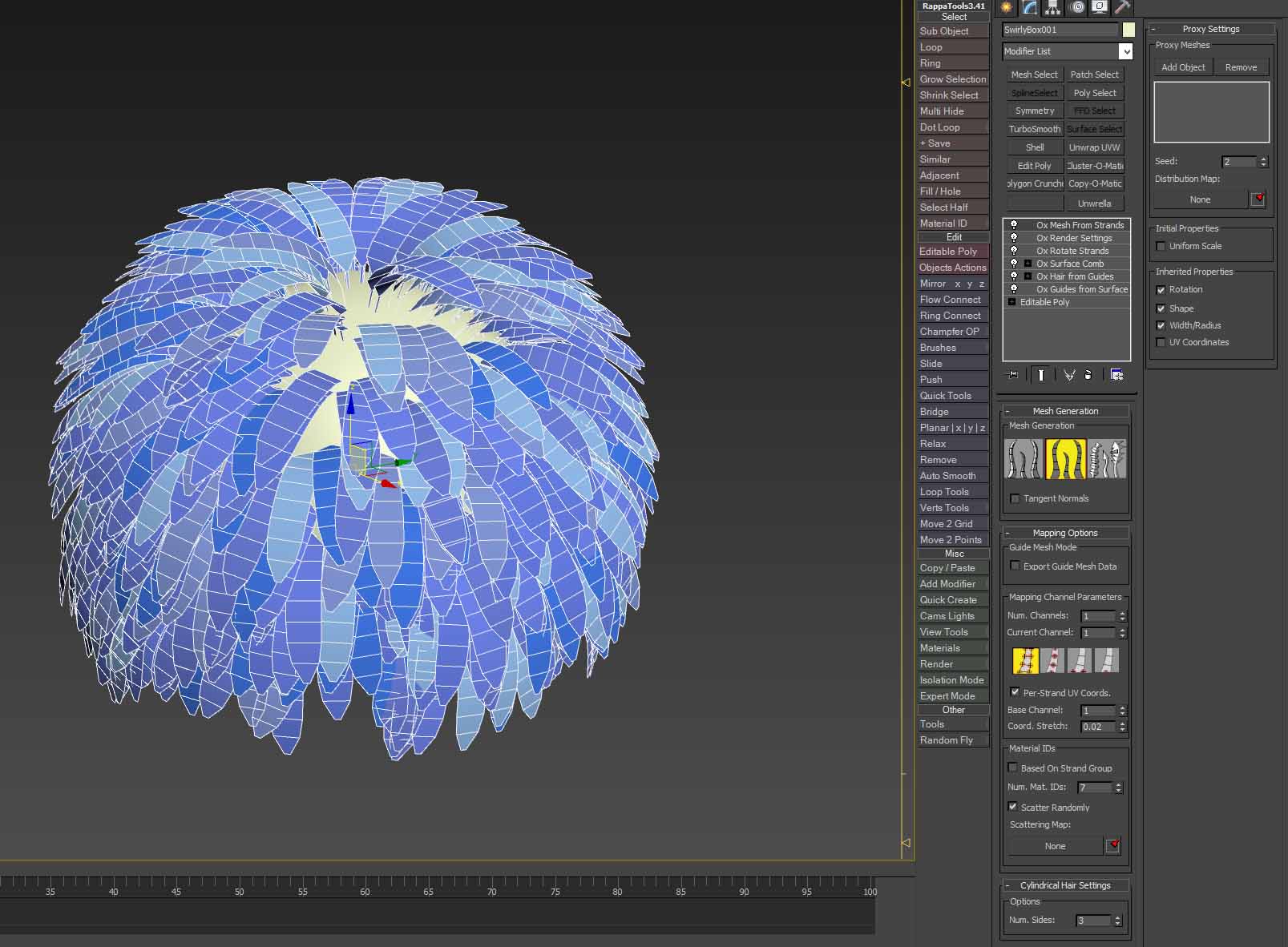

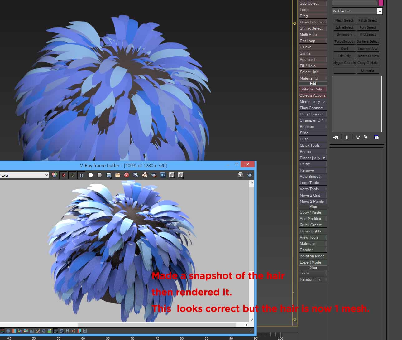

Michael, one other thing, why do some feathers render with some weird twist while it looks fine in the viewport? I have set the viewport amount the same as the render amount, so it should render like the viewport.   Menno
This is a better example. you can see the difference between the 2 renders
btw, enabling the 'Export Guide Mesh Data' does render the feathers without twisting, but it ruins the UV's on the feathers.
Menno
Image 1Image 2
