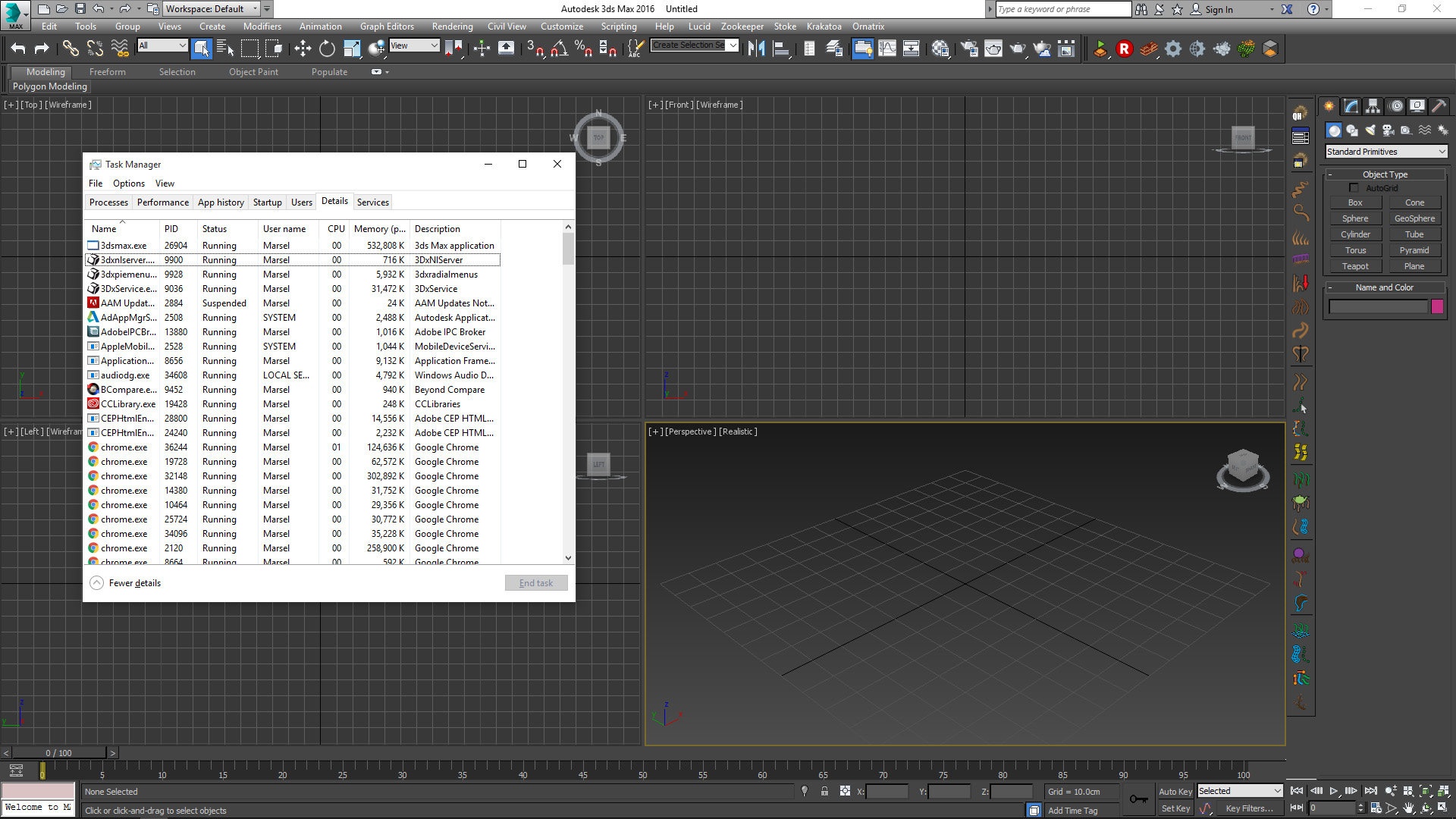

 | Strange, I cannot reproduce that here. I just started Max with nothing else going on and my process monitor goes to 1% at times but mostly it is at 0%, see screenshot.  Attached Files: Marsel Khadiyev (Software Developer, EPHERE Inc.)  |

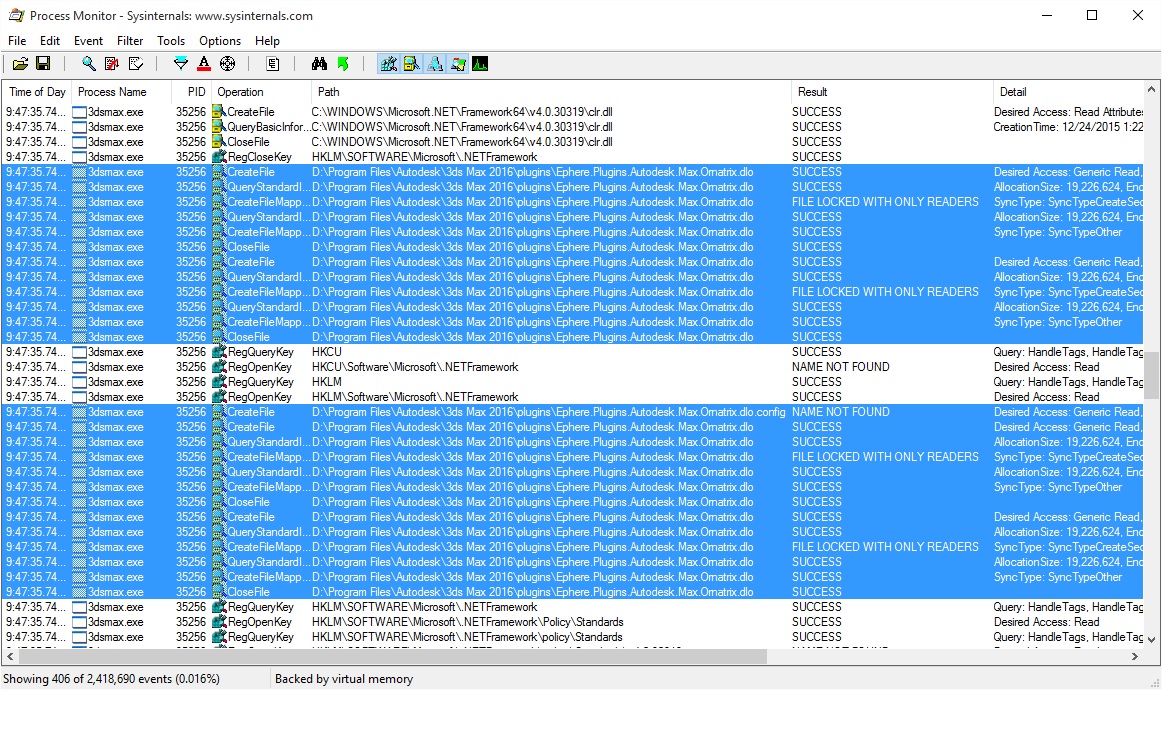

 | Your system services applications much faster than mine :)       You should try Process Monitor to check the file accesses (not Task Manager).   From www.sysinternals.com   Include a filter to log any process name starting with '3dsmax' (without quotes), start logging, and then start 3dsmax.exe.   You'll get a lot of irrelevant Windows-related and other processes. You remove them from the log by adding exclude filters for their process names and refreshing the log.   Or let them there and Ctrl+F to search for any ornatrix entries in the log. They come in blocks of lines.          |
 | Thanks for the explanation, I didn't think of using procmon for this one :) Just to be sure, are these also the events that you're seeing?  Attached Files: Marsel Khadiyev (Software Developer, EPHERE Inc.)  |
 | I'm not at a computer now but yes, they look like that.      |
 | After doing some more monitoring and research it looks like these are normal calls, other plugins also perform them (for example, mfcm110u.dll does the same). I couldn't get anything in Ornatrix to respond during these times indicating that it might be 3dsmax initiating these actions.   Also, these calls stop here after a bit and are no longer repeated it seems. Marsel Khadiyev (Software Developer, EPHERE Inc.)  |
 | mfcm110x and similar DLLs are support routines that many plugins/executables use. They can't be avoided.   The Ornatrix calls seem to be acive when the Max screen has focus. Maybe some sort of a callback somewhere. It could be Max caches it out and keeps reloading it. I can only guess here.   It got my attention because I have many things loaded in Max on the test machine and the other plugins were quiet until actually used.   Anyway, it was just cuiosity. The activity doesn't cause any harm to warrant further wasting of your time.   Thank you much for checking it out.          |
