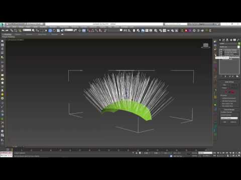

I will whip up a quick video today to show the basics.. Nothing fancy ;)
Thanks
Michael
Michael's video:
tsYj6K8JV6g
Wow.  Excellent response Smile
I understand now what I was doing wrong.  Thank you.

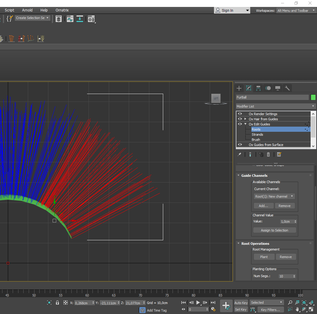

Thank you :) We will be expanding on it further for V5
There si a problem, i have the channel value option, but its not displaying the short cut numbers. Also There is no Channel manager option. Its Ornatrix version 5
