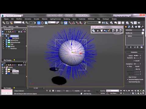

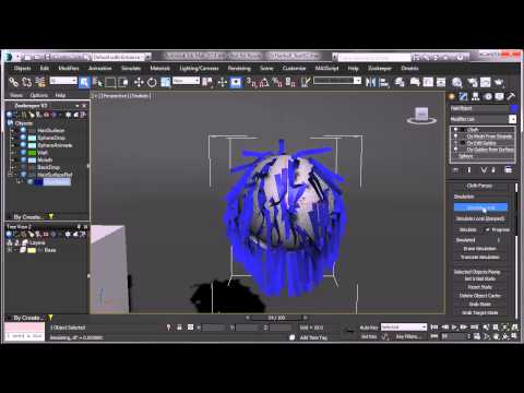

For dynamics I would take a look at these videos. They should get you to where you need to be
h0U0rC53qXQ
oR2QxOLKF2g
