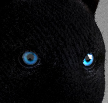

Guides per vertex distribution with Hair from Guides set to random area, high density, short fur is creating grid patterns in the hair.
Using surface comb instead of edit guides seems to alleviate the problem. Any idea why?

we can pretend no longer, definite grid patterns showing up. Replacing the Hair from Guides modifier solves the problem - same settings, maybe it gets corrupted?
