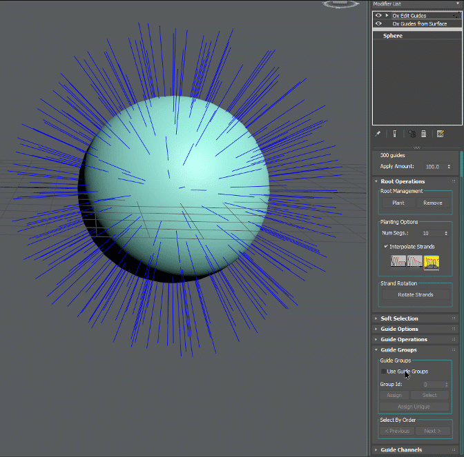

First the Guide Groups:
it feels too much like a random gamble to set those up. I understand the process, check the box, select guide, set a group ID, click assign, and done... right? Except not. It works once, and then for some weird reasons it just won't happen again. Not handy at all. My feeling is it should function the same Poly smoothing groups function? So when you select your guide you can clearly see what Groups they belong too and what not? Being stuck to one color per group isn't good enough. Also why oh why does it stop funtionning after a while? I deleted my guide groups, tried to recreate new ones, and nothing.

| Hi Adriano, Thank you for your feedback. I just tried here and the Strand Groups are working as intended. Which build of Ox and Max version are you using?  I agree about being able to identify which group is selected, we will look into that. And I agree our docs need an update, actually we are working on it. Attached Files: Jeordanis Figuereo (Product Designer. EPHERE Inc.) |
| Thanks a bunch for the feedback guys. I think beside the issue i have with parting, seems the clicks aren't registered by 3ds max when i do so, all my comments / complaints up there are obviosuly lack of experience with Ox. More things make sense now, and thanks for that animated gif, i hadn't seen it before and i understand the process now. it's nto what i was doing indeed.
