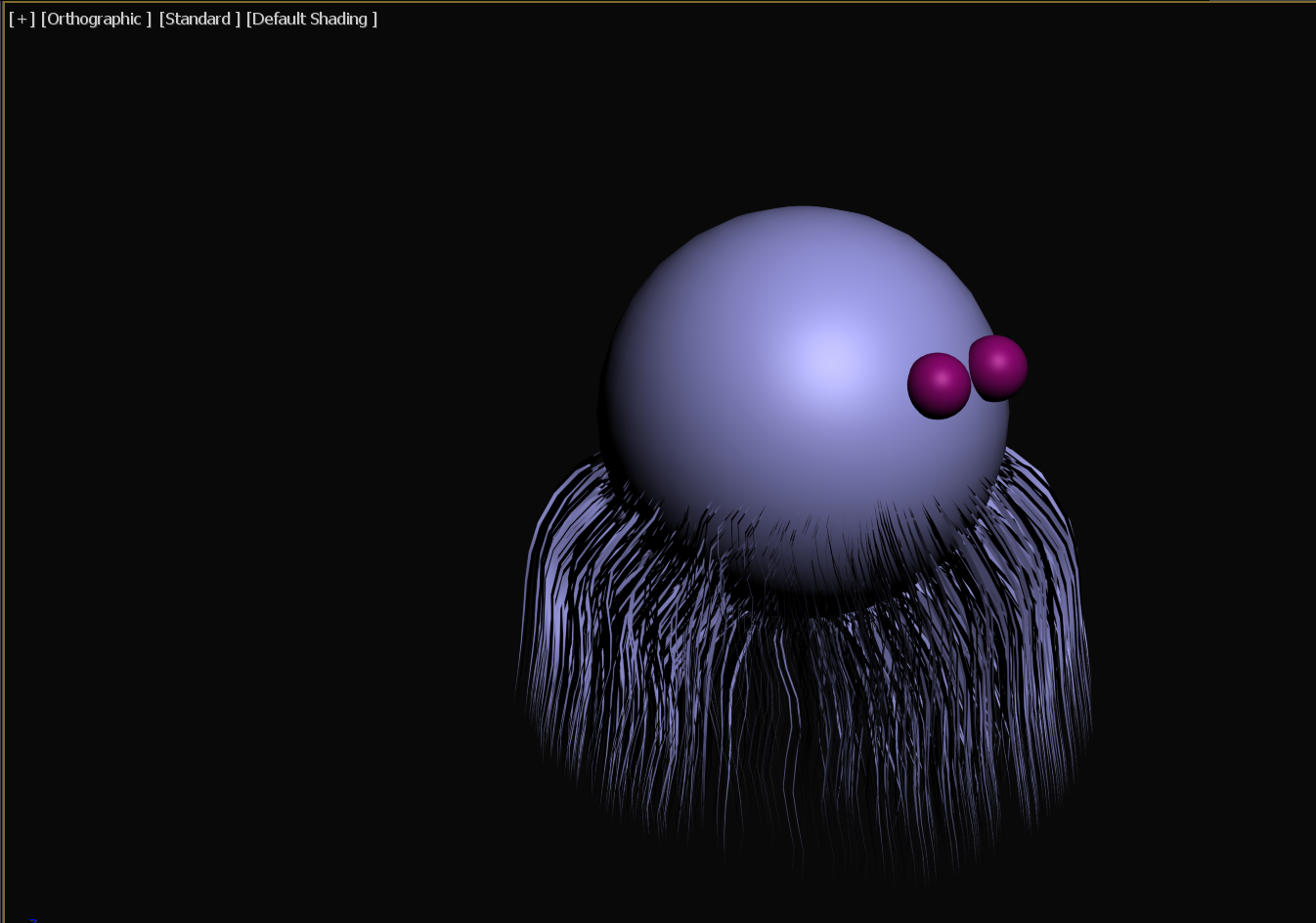

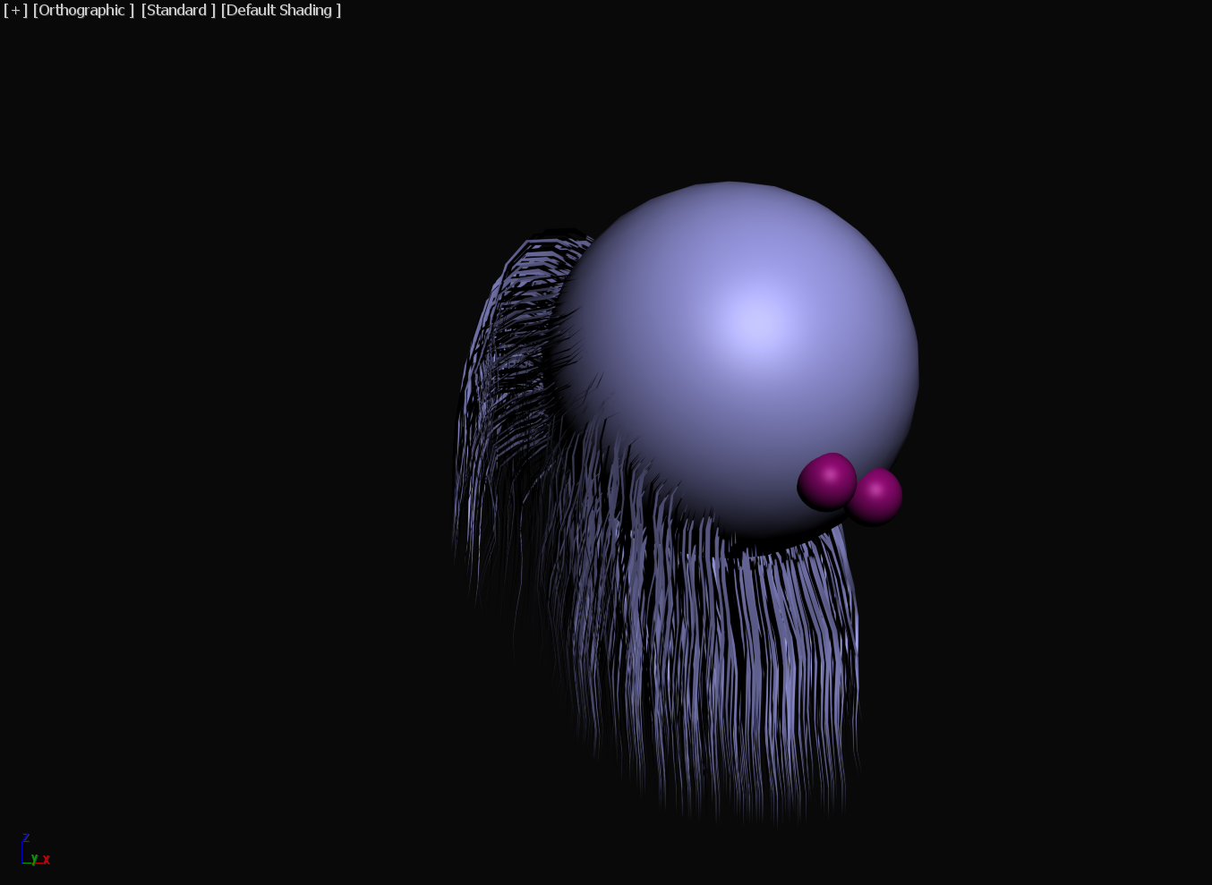

| Thank you very much, So say in the example, I have a character, that I need to pose in a few stills. Because it is not for animation I don't really need a dynamics setup, I just need to take renders in a few different posers. A quick way is to use the Gravity modifier to easily get my still shots. But everytime I change the pose, I have to delete the gravity modifier and put it back on to get the updated pose. If there was a refresh button or something it would be good so I don't have to re-apply the modifier everytime. Even if this could be triggered by maxscript it would be great Attached Files: 1.PNG
(389167 bytes),
(363288 bytes),
| Ox don't have this function right now, but you can change the gravity direction by selecting the Gravity subobject and rotating the gravity plane. What you suggest is a good idea, we will look into it, thanks!
