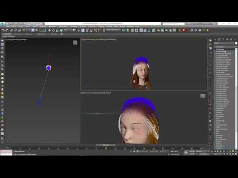

I'll take a look into the VRayDistanceTex, but I think you can use the GenerateGuideData modifier to do the same. Here is a video:
XkwYvEAM1mQ
Thanks Jeordanis,
I got the hair to shrink and do cool stuff using the Generate Guide Date mod, but seems to only work based on distance to a transform of an object. Is there a way to get it working with geometry? Can't find any documentation on this. Also I see that there's an option for "Inside of an object" but not sure how to use it. Thanks!
