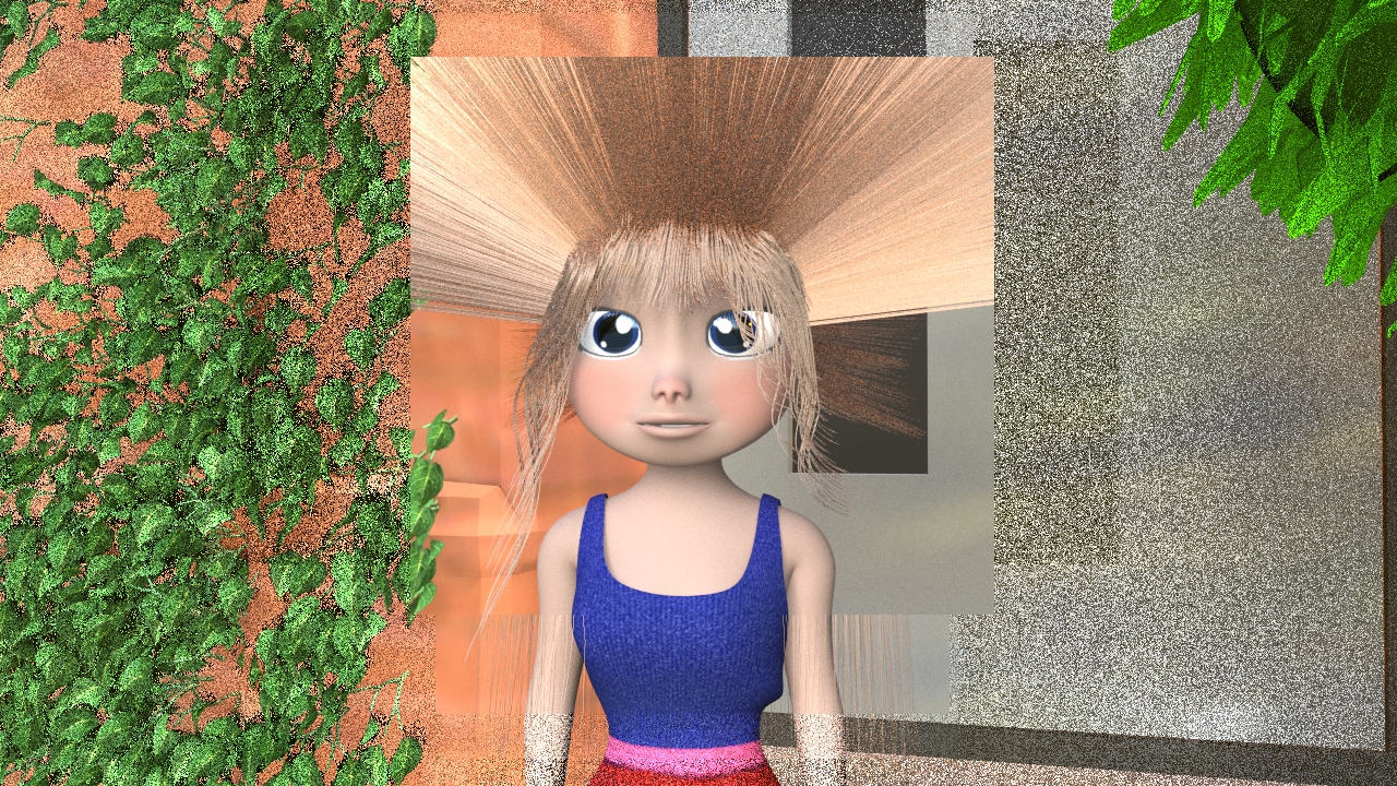

| render without alembic cash In the first picture IPR render there is no problem but In the second picture ... Attached Files:  softlearncg.com |
| Please try again with Redshift v2.5.51 and let me know how it goes. About the crash, what parameter and which operator are you changing? I cannot reproduce this crash, can you record a video showing how ti crashes? Jeordanis Figuereo (Product Designer. EPHERE Inc.) |
