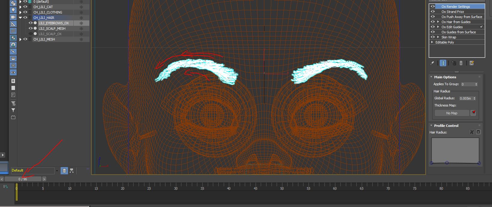

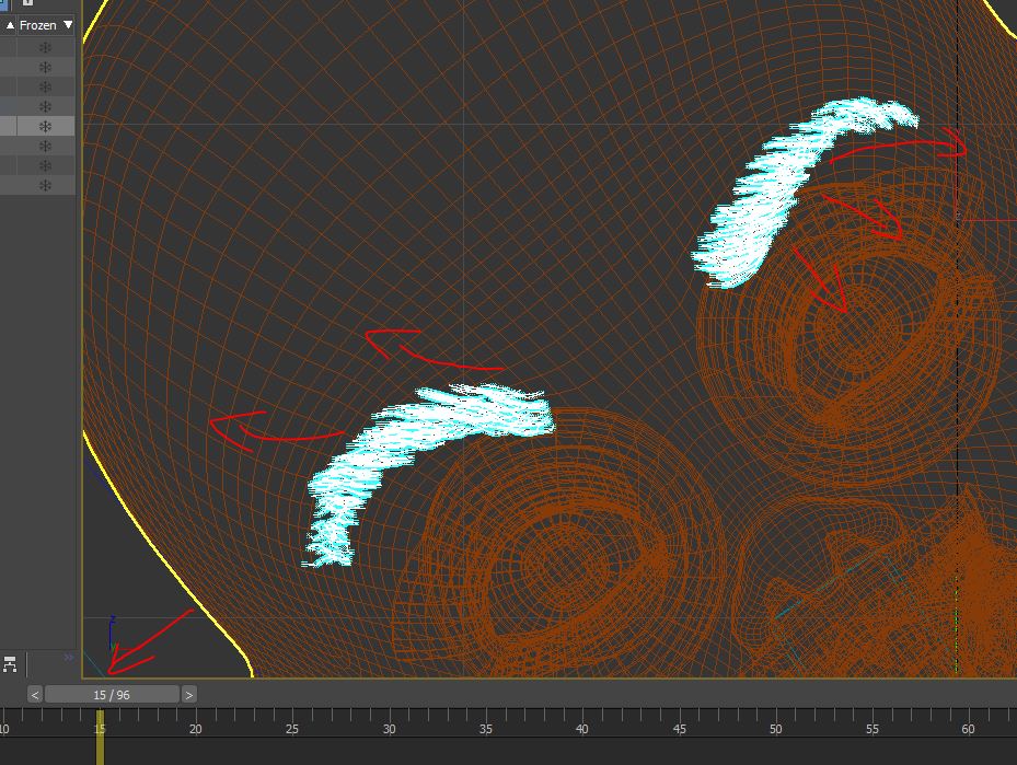

another thing that Im noticing...I just installed latest  beta 6 to play...and whenever i bind the hair (eyebrows and beards for example) with skinwrap to the character mesh, IF I turn the head..the hairs will follow but not with the same initial shape as they were made...how to avoid that?
Please see attached
