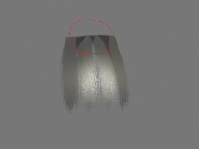

The overlap is the problem I have , is there a way to keep it from being dark?
3ds max 2018 , scanline , render to texture , 2048.

Heya,
I think it is an opacity problem. It looks like th hair is fairly transparent at the roots and overlapping is causing the darkening. You could make sure the roots are not transparent and that might help.

....hhhm, that seemed to create more shadows, I also disabled shadows from the light. I posted the scene file and tga so if you have time to look at it , you could tell me what I did wrong. Also , I included a jpg of what i'm shooting for. Thanks

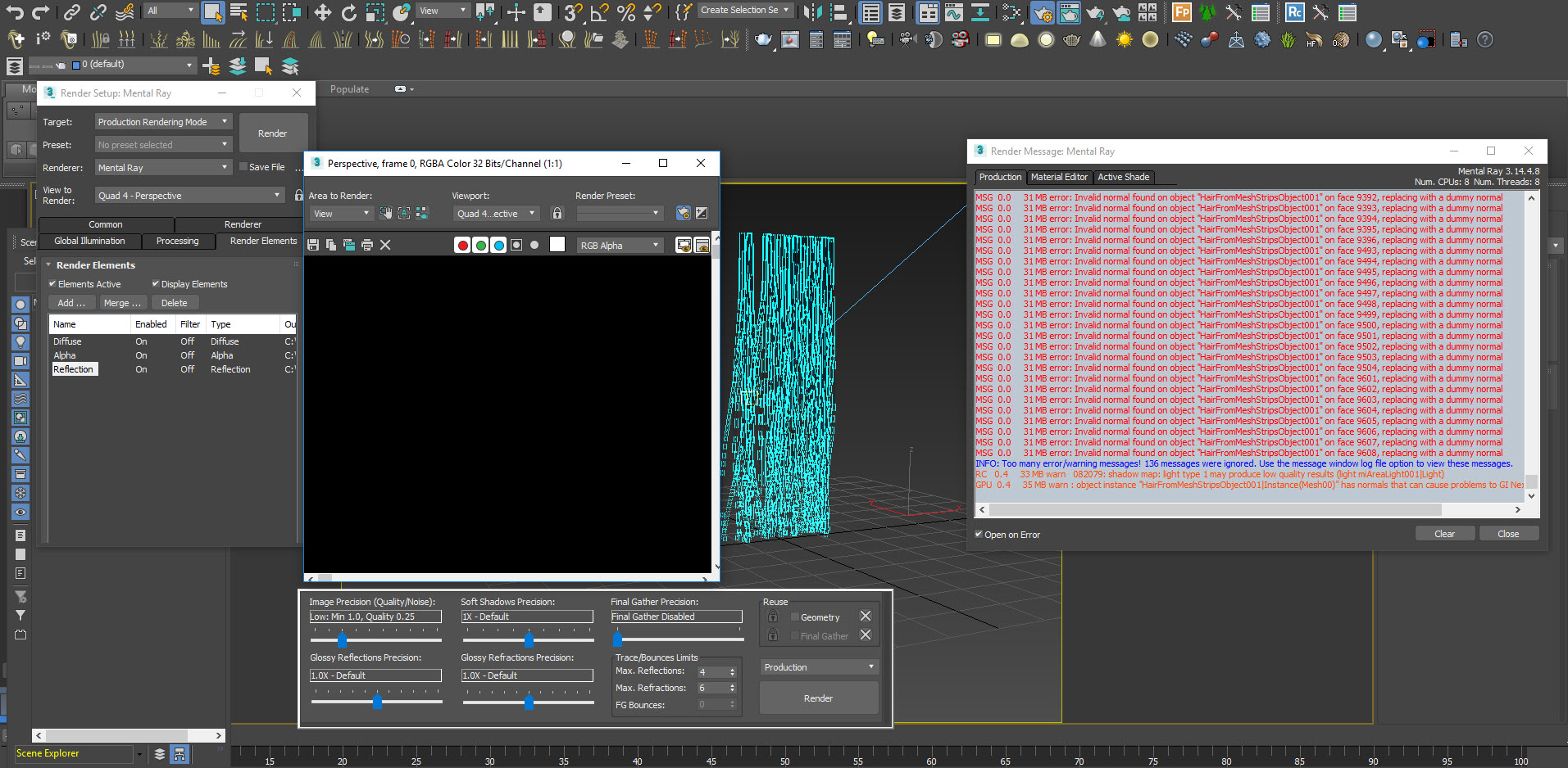

well, I thought maybe rendering with mentalray would help but this is what I got........ "31 MB error: Invalid normal found on object "HairFromMeshStripsObject001" on face 9603, replacing with a dummy normal"......... and it renders black
