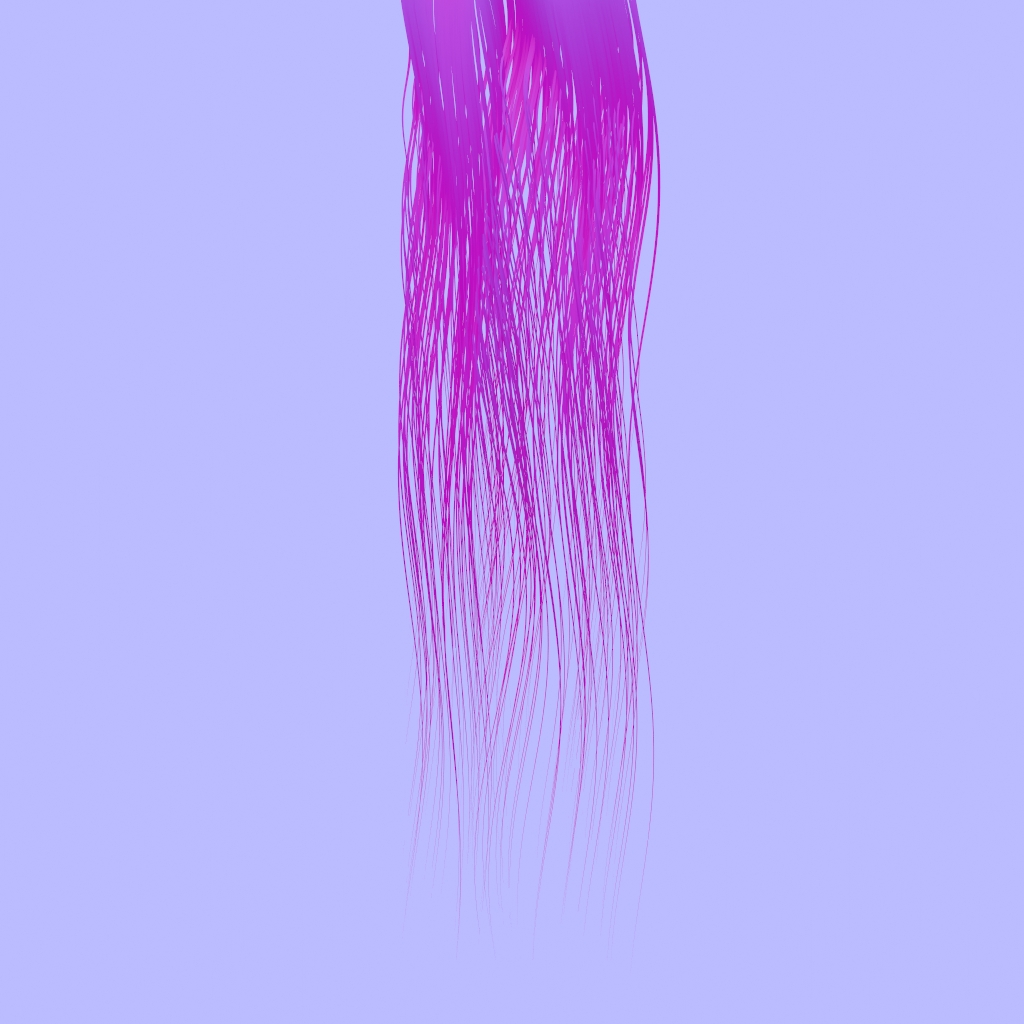

Having seen the video (Ornatrix Texturing For Games) I have two question regarding Max:
1. Which Map in 3DsMax is the closest equivalent to Maya's VRayHairSampler?
2. My Tangent Normal Map looks different than the one on the tutorial. Are my values correct? please see attached image.

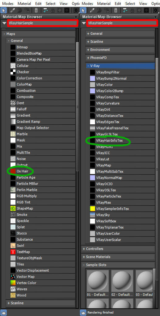

I can see the OX Hair and VrayHairInfoTex but not the VRayHairSample. Where is it?

Maybe VRayHairSample has been removed on new versions of VRay. According to VRay's documentation, VRayHairInfoText allows to the exactly the same:
https://docs.chaosgroup.com/display/VRAY3MAX/Hair+Information+Map+%7C+VRayHairInfoTex
Hi there, any news on that TangentNormal Map?
For that map I cheched the Tangent Normals Box under Mesh Generation Tab (MeshFromStrands Modifier)
We determined that the normals looks correct. To test it, create a shader like I did in the following video, the specular lights should follow the direction of the hair strands:

Hair Sample is not in Material/Map Browser only Ox Hair and  VRayHairInfoTex.
See VRay docs here. You can use that and map it according to randomized strands.
