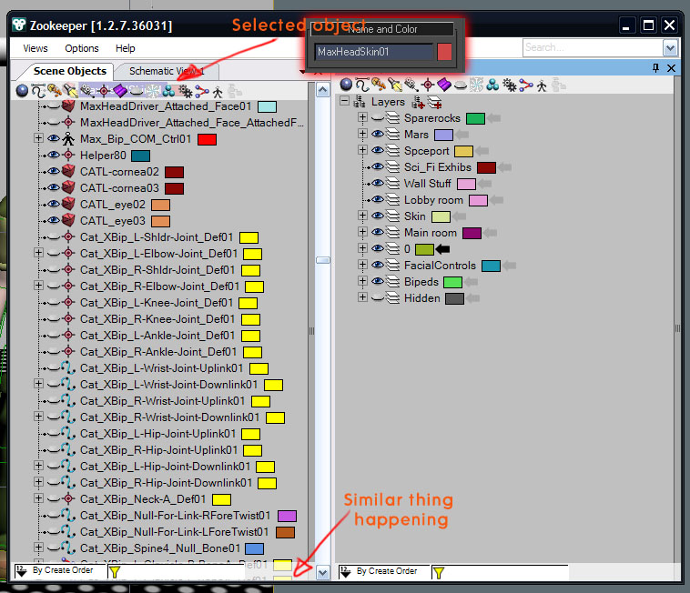

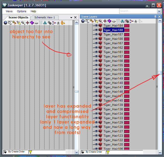

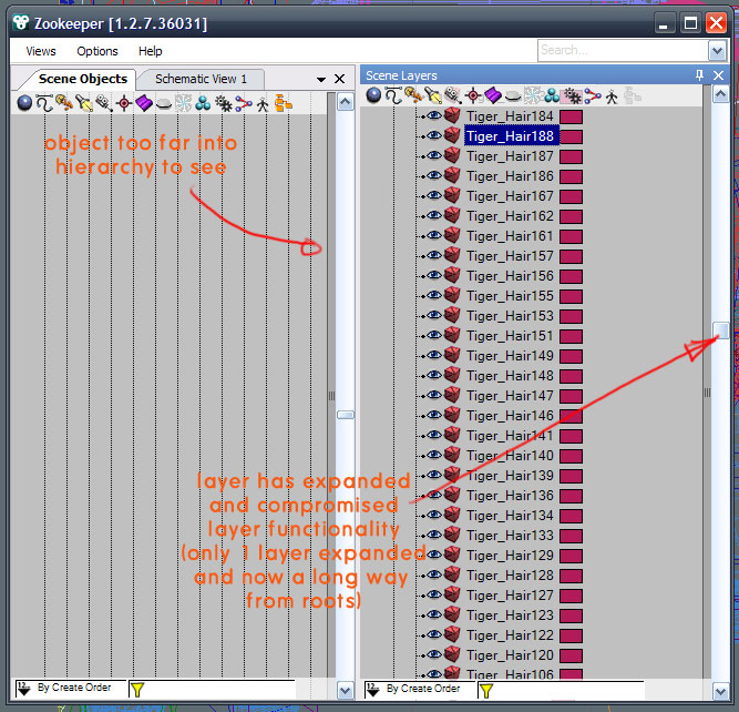

Hi Marsel, Thanks for getting back to me so quickly - I'm pleased you are looking into my suggestions (its actually Sean at Jtronix - I work with Jon and have been doing the testing at the moment). I'll certainly keep my feedback going if it is helpful to you. The issue where the selected object appears underneath the filter icons I can show you with a screenshot when im at work tomorrow - I would imagine it is a bug, as the object text appears directly behind the icons (i should have said behind rather than underneath before) - so that the icons appear over ghosted text. Cheers Sean. | |
| 2 March 2010
#1467 | |
Hi Sean, A screenshot would be very welcome. And if you find more stuff please do post it. Marsel Khadiyev (Software Developer, EPHERE Inc.) | |

Thank you for the screens. I can see the problem in the first one. Seems a horizontal scroll bar is in order for those scenarios. I'm also considering adding an option to limit initial node count for each hierarchy tree (until you expand furhter). That could help the layer expansion problem. As for the filters blocking the view- I think the best thing there is to make the semi-transparent filter option bars auto-hide when not in use. Marsel Khadiyev (Software Developer, EPHERE Inc.) | |

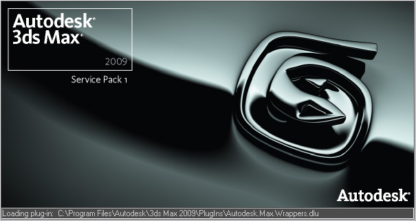

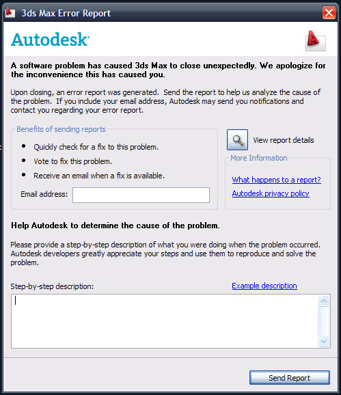

#1476 | |
Hi Marsel, Heres a little more info on the max.wrappers crash. It happens fairly frequently when loading 3ds max - 1 in 6 roughly. Ive attached two pictures in sequence showing the crash. I can view the report details which has a minidump.dmp, dmpuserinfo.xml and dumpdata.zip in a temp folder, so I guess i could save these out and send them if its any use. The other issue of changes multiple values on different nodes is still troubling. I can change 2 values that are definately the same for example noise size on one node and noise size on another. But not a cellular size and a noise size for example. It would be really great to be able to highlight values with something like a ctrl+shift click and adjust them all at the same time. The other method of putting a controller into two values creates a crash - steps to reproduce - create an arch and design mat in the schematic window, pull out the diffuse roughness node and create a bezier float, select use control value, plug this into the reflection glossiness aswell, drag the value in the bezier float (should crash). I think being able to wire these parameter together, or even just adjust the values at the same time would give massive potential to create very powerful materials. For example i could create a metal with a rustiness slider which would change bump strength, noise amount (even use an expression to bring thresholds in), specularity all in relation to each other. Or if i could change the values at the same time I could wire up these parameters through a composite node and select all these parameter and adjust. Cheers Sean. | |

Hi Sean, Something strange must be happening on your machine (maybe related to the periodic startup issues you reported). This is what I just tried here:
Everything worked out fine. Can you confirm crashing while using these steps? If not can you please list the steps to reproduce the problem (I'd be really interested in fixing it). Thanks! Marsel Khadiyev (Software Developer, EPHERE Inc.) | |

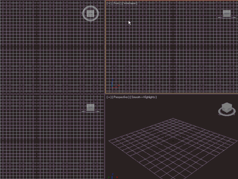

#1493 | |

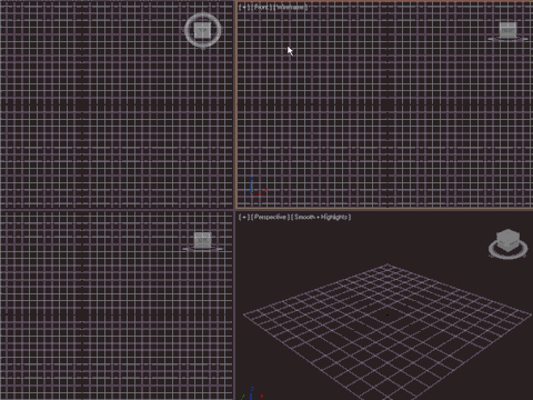

Hi Sean, I did find one error when trying to adjust parameters of a noise map. This was apparently introduced a couple of builds ago and I just fixed it for next build. However, I experienced no crashing. I am attaching a small screen capture of my steps so perhaps you can see if I'm not doing something in the right order. Sorry about the size and quality, just wanted to make it fit in here. Marsel Khadiyev (Software Developer, EPHERE Inc.) | |

Hi Marsel, Sorry - I shouldve been more clear -You need to do what you did in the gif with an arch and design mat. It should crash when you plug a second node in. The reason I said its a material editor issue is that you can use an arch and design mat properly if your mat editor renderer is on scanline. Cheers, Sean. | |
